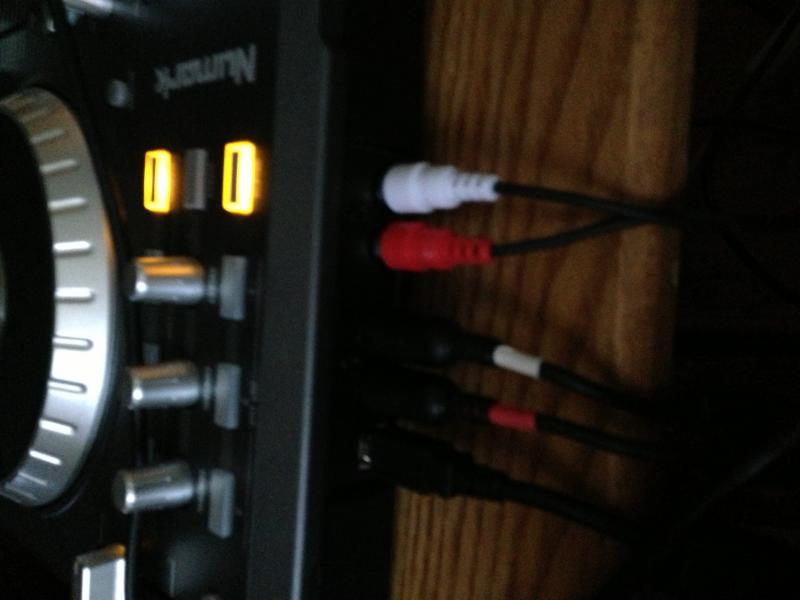

Back of the controller
Posted Tue 27 Aug 13 @ 7:03 pm
The red and white are connected to my main unit for the speakers the black ones is connected to lap top
Which is what I read to do
Sound config is on Numark sound card input none output headphones main 1&2 headphones 3&4
I have unplugged the cord to lap top to where just the USB is connected to lap top and still have to have speakers on lap top for sound
Posted Tue 27 Aug 13 @ 7:09 pm

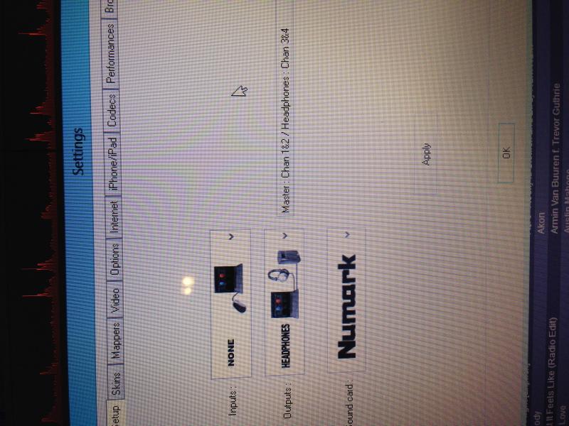

Here is how I have my sound set up and I unhooked the RCA from lap top to controller
The only thing left is USB from controller to laptop
RCA from controller to main and STILL no sound unless I turn on laptop speakers
Posted Tue 27 Aug 13 @ 11:57 pm

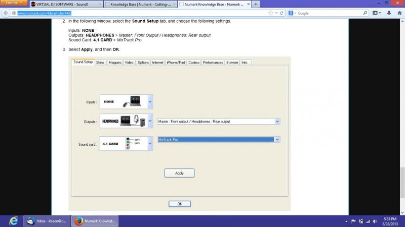

http://www.numark.com/kb/article/1408
Numarks sound setup looks like this.
Posted Wed 28 Aug 13 @ 4:28 pm
That looks a lot better, can you get these options in your config?
Posted Wed 28 Aug 13 @ 4:32 pm

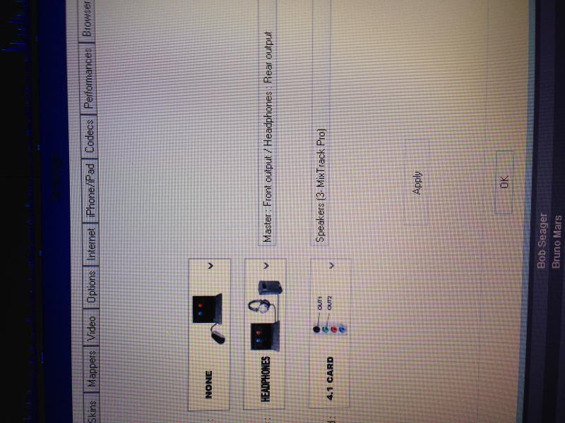

Ok here is how it shows for me and that's how I set it
Now here's the weird part the RCA from the controller is the output and I have it going into
the master output on my main unit which is where I hook up my powered speakers
And finally I can turn off the laptop speakers and I now get sound like I'm supposed to
