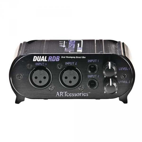

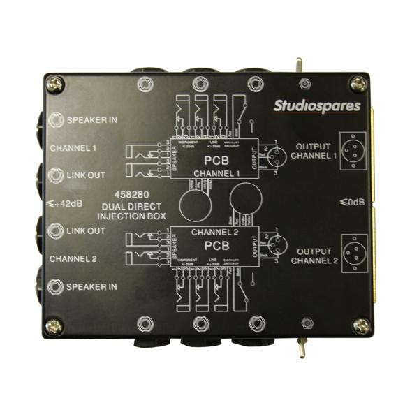

Your best bet is to pick up a convertor that lets you take the Phono out from the Mixtrack using a short lead and feeds out a Balanced line signal on what are called XLR connectors (These are the same as the connectors used for microphones).
They are not too expensive and well worth the investment. Using Phono to 1/4\\\" Jack leads is an option but these can give you some problems with Hum and noise pick up. How big a problem this causes changes quite a bit depending on your setup. You could try them out with the Jacks first to see if they behave. But aim for the Convertor in the end it can save you hours of grief wondering where that annoying Hum or Buzzing is coming from. Something like this
Or this

One of us needs to slow down lol
Like I said tho you can use what you have to try out and see how it goes. There are cables available which have two Phono Plugs to Two 1/4" Jack plugs. You would be better to replace your current wire setup with at least this. The Small size Jack and splitter you have might work for now but will give you problems with bad quality connections quite quickly.
BTW The convertors ( Direct Inject Boxes to give you there correct name) That I have shown are Pro models so might be a little pricey (Only Pics I had to hand) There are smaller and less expensive units that do the same job.
