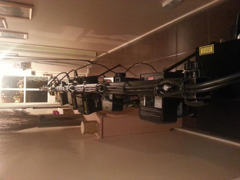

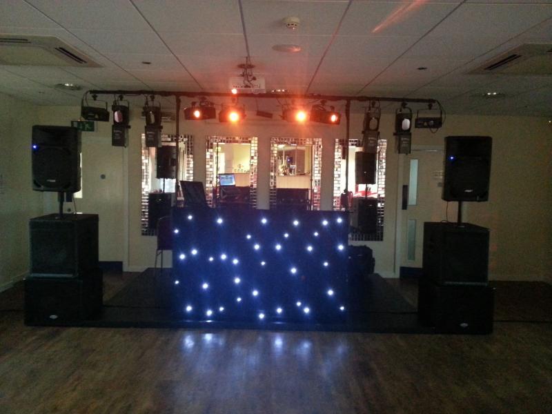

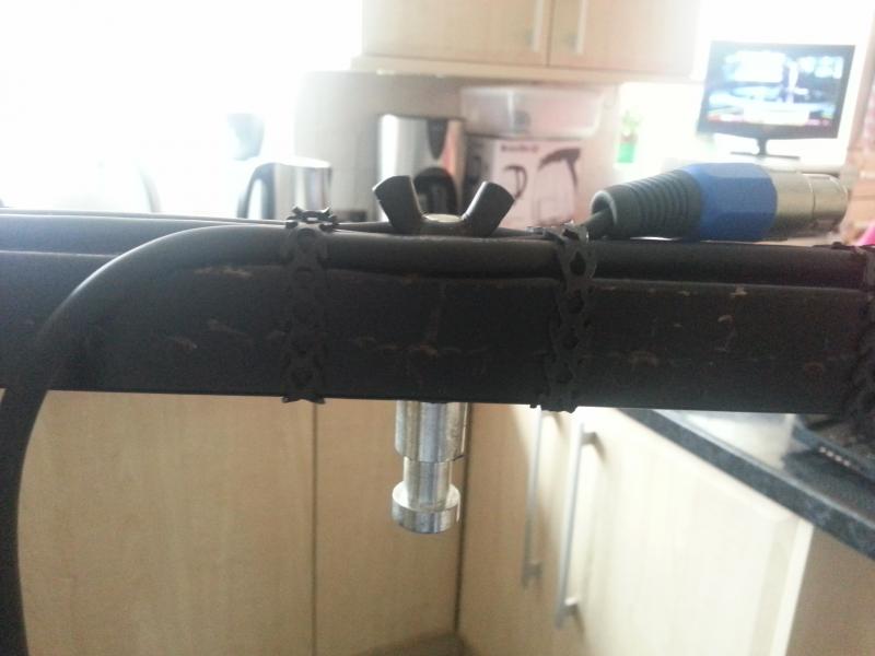

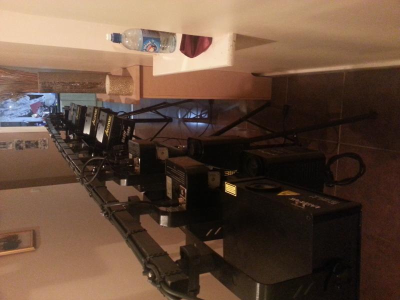

I've just switched to Rhino Quick Clamps - See here for demo...
Must have saved me a good 40mins combined set up/breakdown time now, as I've also been able to pre-wire my T-bars to I just click, tighten, plugin now...
Up close without a light attached
My "loomed" T-bars
View with the lights connected via the quick clamps
And full show using the above.

That's a lorra lorra lights!
