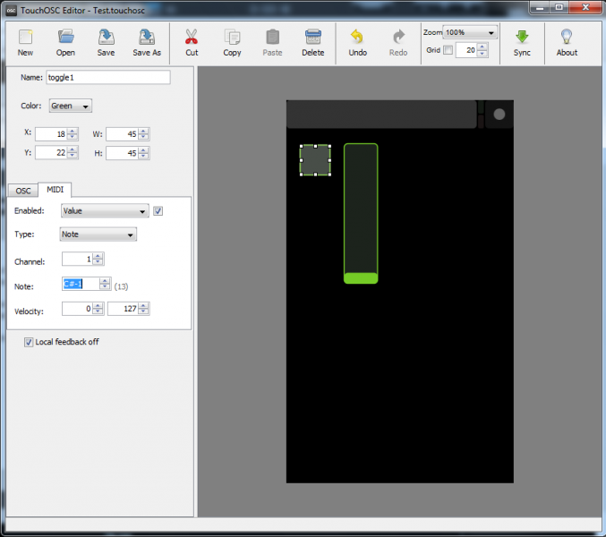

Okay, so maybe i got over zealous with this...
Managed to get the device.xml file setup and managed to create the mapper file too.
Nothing complicated for the moment, 1 button and one slider.
However, nothing triggering in VDJ!
Any thought anyone?

First of all, for buttons you should use NOTES and not CC
Also try to get used in typing the notes and CC's in HEX: 0x01
Finally keep in mind that midi channel 1 of TouchOSC is channel 0 for VirtualDj...
SO:
<?xml version="1.0" encoding="UTF-8"?>
<device author="PhantomDJ" decks="2" drivername="TouchOSC Bridge" drivernameout="TouchOSC Bridge" name="TouchOSC" type="MIDI" >
<button note="0x01" channel="0" deck="1" name="PLAY" />
<slider cc="0x02" channel="0" deck="1" name="VOLUME" />
</device>
<mapper device="TouchOSC" author="MBProductionz" description="TouchOSC Bridge" version="741" date="18/03/2014">
<map value="PLAY" action="play_button" />
<map value="VOLUME" action="level" />
</mapper>

Hey Phantom,
Ignore last message, got it working!!!
The octave range on touchOSC is greater that the chart layout... also me the dumbass didn't notice the value in brackets!
Once again, thanks for your support and help!

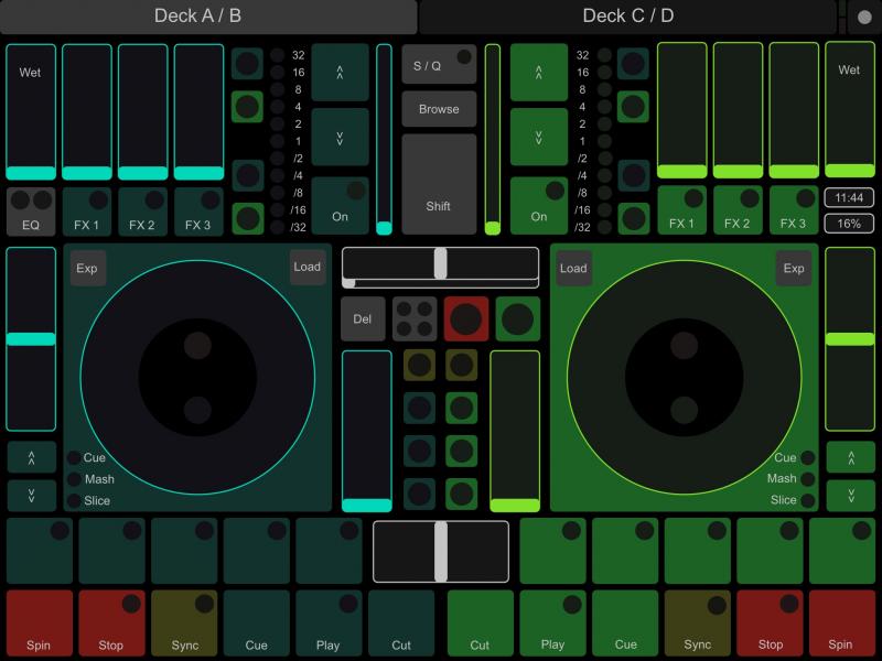

I was just wondering if anyone got this up and running yet??
Here's something I'm gonna start working on,
I just found this so I'll have to go in the editor and make sure everything is right. I'm not very good at this stuff so IT IS GOING TO TAKE ME A WHILE to get this up and running so don't plan on seeing it anytime soon 😜
