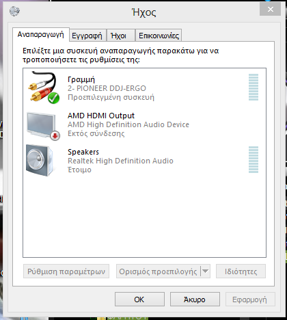

Einai hardware, kai to Master volume kai to Headphone volume, epomenws den nomizw oti i lysi einai mesa apo to VirtualDJ. Kati paizei me to firmware i tous drivers tis kartas ixou.
Des otan vazeis tin Ergo sto USB, ta Windows tin epilegoun san default karta ixou ? Mipws paizoun rolo tipota enhancement pou epivaloun ta Windows stis default kartes ?

me to pou sindeo tin consola kai tin anoigo kanonika meta ta windows kateythian kanoune epilogi stin karta yxou tis ergo...den xero tora an enois ayto??

Wraia, kane deksi klik stin default karta sou (ixeia) kai orise tin san proepilogi (me tin Ergo syndedemeni).
Vgale tin Ergo apo to USB, kane reboot kai des an i Ergo automata proepilegetai san karta ixou otan tin syndeeis.

@Mpampi, Logika mia ASIO karta parakamptei ton kernel mikti ton windows kai epoikinonei me to hardware apeutheias, ara den paizei kanena rolo auto pou blepoume stin eikona epano.
Einai to wdm komati tou driver pou mporeis aneta akoma na to apenergopoihseis apo ton device manager gia na min mplekete me aplous media players. Tha douleuei akoma san asio mia xara, kai auto einai to kalo me tous asio drivers. (oxi me asio4all bebaia)
