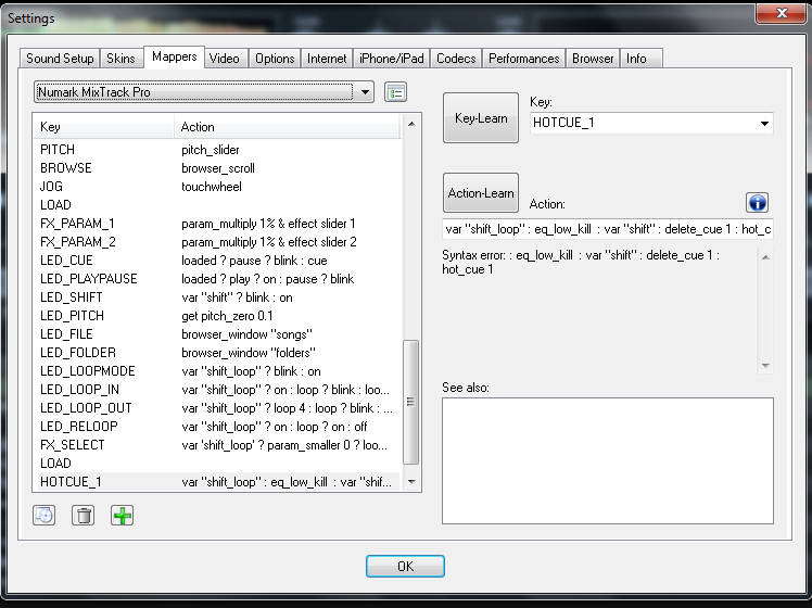

Hi, djdad.
I've tried the low eq kill code, and VDJ is reporting a syntax error - see below.
And also, the hotcue buttons don't work anymore. What have I missed. Any thoughts?

Posted Sun 07 Jul 13 @ 2:27 am
it needs to say
var "shift_loop" ? eq_low_kill : var "shift" ? delete_cue 1 : hot_cue 1
just a simple syntax mistake ;-)

Addition:
I checked the list of VDJ commands, and swapped eq_low_kill for eq_kill_low as per here, and still reporting the syntax error.

Can we run a check similar to if eq_kill_low = true then LED off?
I'm beginning to wonder if you can actually query eq_kill_low, because surely its a command, not a variable? Although the following (from the VDJpedia might suggest otherwise:
"Actions vs queries
Commands can be used either as actions or as queries, depending on the context.
For example, the command "play" used in a keyboard shortcut, will be an action, and start to play the music when called.
The same command "play" used as a mapping for a controller's LED, will be a query, and will return true if the song is playing, or false if not."
Could we say somewhere else on the line if eq_kill_low = true then off (not strictly vdjscript, but don't know how else to put it.)?
My hotcue button needs to check on the following bits and pieces:
Check_Shift_Loop_Button = on.
If true, blink LED at 250ms, and make hotcue button kill bass. Only when bass is killed, turn light off.
If false, THEN check "shift" button = on. If true, delete hot_cue 1, if false, play hot_cue 1.
Again, apologies for the persistence, but its got to be possible...
Ta
Mike.

The script example and explination above is for the led only, not the button on it's own or the led and button together. but you can easily change the script for either
this would be for both the led and button mapped at the same time "If you can't see an individual LED that can be mapped for your hot cues in the mapper list use this script"
var 'shift_loop' ? eq_kill_low ? blink 250ms & eq_kill_low 0 : on & eq_kill_low 1 : var 'shift' ? hot_cue 1 ? blink 500ms & delete_cue 1 : off & nothing : hot_cue 1
It can get a little confusing when mapping the led and button together as you need to put the led commands and action commands on opposite ends of the condition.
this would be for the button on it's own and you could use the original script on the led, this is an easier method but takes more duplication of the script so not ideal unless you want to get really in depth in mapping.
var 'shift_loop' ? eq_kill_low : var 'shift' ? delete_cue 1 : hot_cue 1

Just to add a few notes...
You actually need to control 2 things here... one is the action that the button/slider will perform depending on the state of your Shift buttons, and the other one is how the LEDS will act (on/off/blink) on each case.
Most of the controllers have pre-mapped the LEDs but those are not present in the mapper (action/key lists), as they follow the buttons (pre-assigned in the definition file as value="default")
You can use of course the button/slider to control the LED as well, but you can also split the actions and have different for the button/slider and diferent for the LEDs. This may also be easier as the total actions will not be that long and easier to understand.
Particularly the MTP has LED_HOTCUE1 elements (can be found on the Key List on the top right side). Not sure if you have already used and mapped that, so that could be the case if your Led works correctly or not.
Some examples
Case 1. HOTCUE1 mapped/ LED_HOTCUE1 unmapped (empty)
HOTCUE 1 ->var 'shift' ? delete_cue 1 : hot_cue 1
In this case the LED will always stay on if hotcue 1 exists
Case 2. HOTCUE1 and LED HOTCUE1 mapped
HOTCUE 1--> var 'shift' ? delete_cue 1 : hot_cue 1
LED_HOTCUE1--> var 'shift' ? blink : hot_cue 1
In this case the LED will blink if SHIFT is pressed (delete mode) and will follow the hot_cue if not, meaning that it will stay off if hotcue 1 doesnt exist and on if it does. When you use actions in the LEDs, those do not perfom any action actually. They just query the state true/false and light on or off the LED.
Case 3. Control both Led and button with the button (LED unmapped)
HOTCUE1--> var 'shift' ? blink & delete_cue 1 : hot_cue 1
In this case if SHOFT is pressed the LED will blink and the button will perform delete, and if not pressed the LED will follow the hotcue (on if exists and off if it doesnt) and the button will perform the hot_cue action.
Some examples

Guys, thank you so much for your help and kindness.
I settled for the following:
var 'shift_loop' ? eq_kill_low ? off & eq_kill_low 0 : blink 250ms & eq_kill_low 1 : var 'shift' ? hot_cue 1 ? blink 500ms & delete_cue 1 : off & nothing : hot_cue 1, which is more or less synthet1cs code, but with the LED flash and off swapped.
Now, with "shift_loop" pressed, all three hot cues flash, and stop flashing when the kill is in effect - exactly what I wanted. I hope not to bother you all again with my persistence in the near future.
