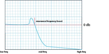

The reason for the distortion is that you have the resonance turned up. Essentially what it does is boost the frequency right before the cutoff. I made a picture to show you. Imagine that the curve in the blue line can move horizontally along the graph, but when moving it will always boost just before the cutoff
