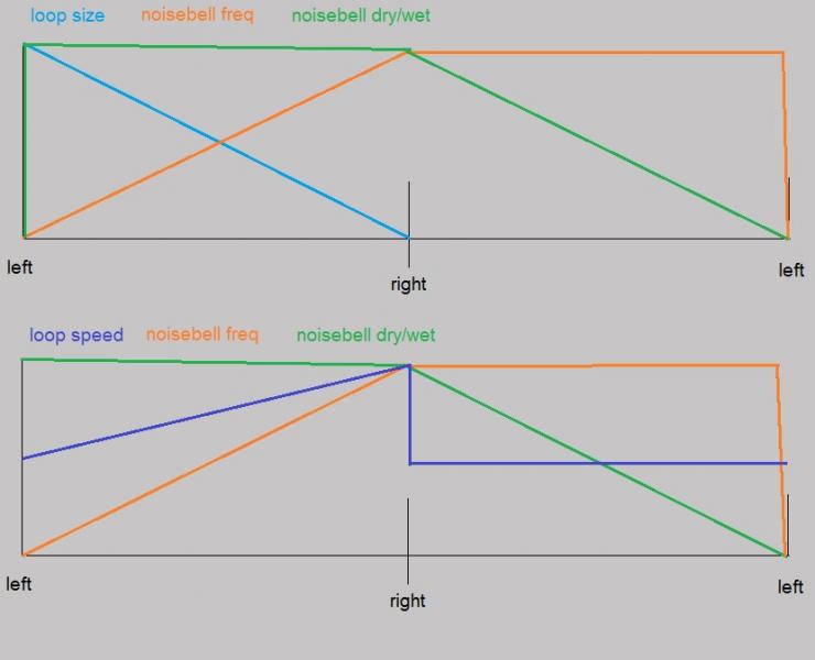

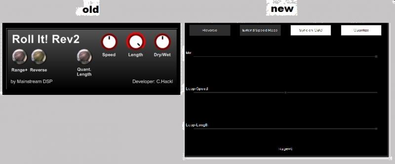

that's weird... The first mapping should start with the loop size at 1 beat, then as you progress through the motion the loop size will become smaller. The second mapping should have the loop size set to 1 beat and instead speed up the playback of the loop. Is it accessing the new rollit, chackl changed what the sliders control so it's not compatible with the old effect. To confirm it's the new one check if it looks like all the other VDJ effects and doesn't have a custom interface see below.
Posted Fri 12 Jul 13 @ 9:58 pm
Posted Fri 12 Jul 13 @ 10:16 pm
This is exactly what it is supposed to do in graph form, I haven't got a mac to test unfortunately. The x-axis is the knob position, the y-axis is the effect slider value.

vdj can't handle the effect pannel being open when two effects are mapped to a single knob, you have to close the pannel and go back to the browser/sampler, if you need to see the sliders move you have to use a skin that shows more than one effect slot, the only one I can think of off the top of my head is phantoms cds4 which has 3 slots and 2 effect parameters per effect.
actually I think I know why... you have noisebell in it's own separate folder, VDJ can't reference it with script, you need to put the effect in the same folder as the rest of the effects, otherwise the mapping will work on any effect that is selected. (at least that's how it works on PC, VDJ8 should see that fixed though).
And actually the noisebell's dry/wet is set at 20% on the first pass and from 100% to 0% on the return, the graph is a little wrong

sure, P.M. me your email address and I'll make a quick recording. I'm not sure why it doesn't work for you through I have now mapped this to my VCI-400, novation nocturn and even a skin knob and it works perfectly on all accounts...
