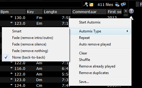

Hi Everyone,
I recognise that this thread is old, I'm hoping there will be some work around available now.
I mix tango music, sometimes with dubstep songs, sometimes classical.
For the classical songs transitions, I need to auto add 3-5 seconds of silence between tracks, for the dubstep, I mix the songs continuous.
Having to create a 3 second "silence" track to put between each song in the classical sets, is a real pain in the backside, it would be really helpful to be able to specify a silence of a set length in the automix settings "None (back-to-back)" option....
Is there any way to do this?
Thanks,
Oliver
Thanks,
Oliver
