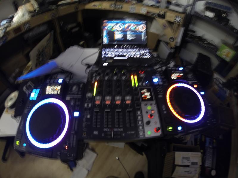

Regarding my "dark" 2900, is it a "midi CH" issue? What should the midi channels be set to on each SC2900?

I decided I had to make a run home @ lunch break ;)
Mixer/soundcard works after I made the necessary changes.
AND
set the naughty \"dark\" 2900 #2 back to the (default) midi channel 1...presto, no longer \"dark\"! So the midi channel does matter...begs the question how it will/won\'t work using a powered USB hub....

Yes the MIDI channel does matter. When a unit is set to wrong CH number VDJ won't be able to send any MIDI out commands (and thus turn on leds, update screens, e.t.c.)
