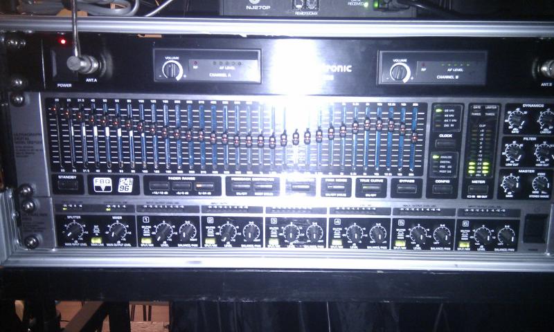

I have a hardware EQ in my sound rack. One of these actually Ultragraph Digital DEQ1024.
Picked one up on ebay for less that £100.
What I like about this EQ is:
I use this in conjunction with an Ultralink PRO MX882 which works great as I can chose whether each channel is an input or output and when I have used to to control multi room set ups, but also when doing karaoke I plug the my Xenyx 1204FX in to the Ultralink to keep the karaoke mics apart from the MC6000.
Again picked up the MX882 for less than £100 both brand new...
As can be seen here... Have upgraded the mics since...
- It's a stereo EQ with only one set of controls - so easier to configure
- It has a built in feedback destroyer which works great for weddings/karaoke when the mics need to be out front
- It has a built in limiter so even if some numpty comes up and maxes out all your hardware controls, it won't do any damage to the equipment down the line - also good where the venue has it's own sound limiter so you can set your maximum just below it's cut off
Cheers,
Roy
