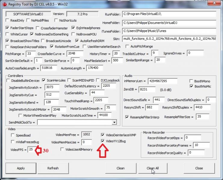

There could be a number of reasons:
(1) Your computer is not optimised for DJ performance. Most shop purchased computers are built with typical home/office users in mind and may perform poorly until optimised. Please see https://virtualdj.com/wiki/Performance%20Issues.html
(2) Issues with your video card drivers or your system has dual video cards (One performance and the other basic to conserve battery life.) Please see our FAQ pages: https://virtualdj.com/wiki/My%20video%20output%20runs%20slowly%20or%20is%20very%20choppy.html and https://virtualdj.com/wiki/Video%20Memory%20Issue.html
(3) If you don't have a high performance video card (E.g: You are using basic chipset Intel video), then this may not be good enough for real time video mixing. A high performance video card with dedicated video memory is strongly recommended.
(4) The frame rate (FPS) of the video is different to VirtualDJ's internal frame rate. You can try changing this with the registry tool: https://virtualdj.com/addons/2170/Registry_Tool.html (Try 30 instead of 25)

you can try to check (VidéoYV12Bug)
in Tool Registry djcel in the video section
(VidéoYV12Bug)
OR
(VidéoFPS)
(VidéoYV12Bug)
OR
(VidéoFPS)
