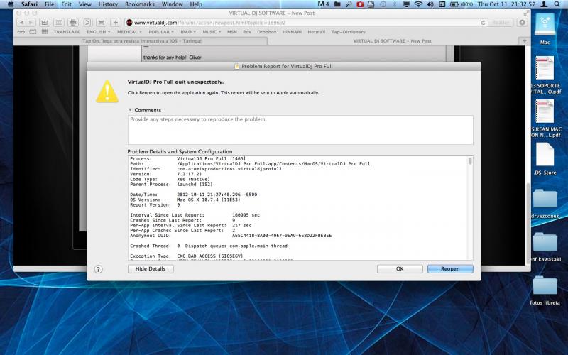

the same here .....I\'ve tried reinstalling many times but VDJ keeps crashing.....any suggestions
thank\'s in advance
thank\'s in advance
