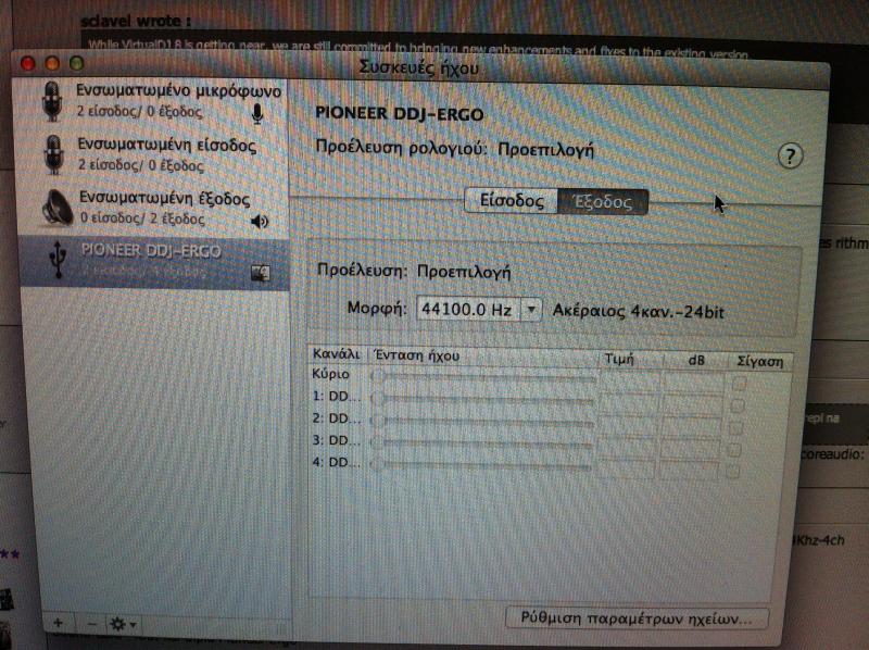

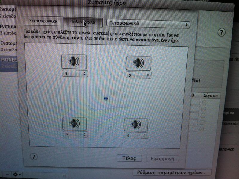

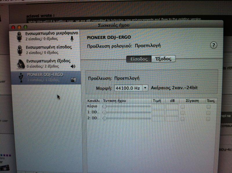

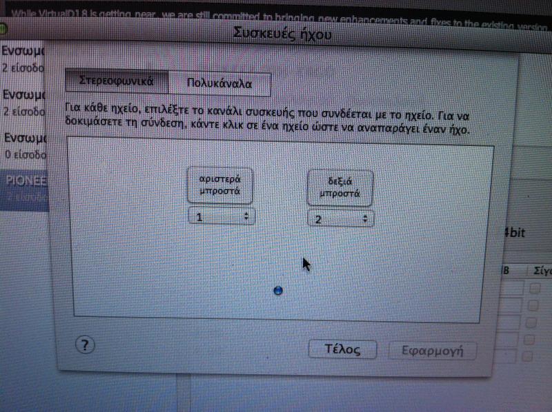

Kalispera djdad :) sou stelno merikes foto apo tis rithmisis pou ekana stin karta ixou na mou pis an inai sostes thnx file mou .
Posted Sun 22 Sep 13 @ 10:38 am
Stin eksodo, prepei na einai 44Khz kai 4ch (opws fainetai stin deuteri photo)
Ta ixeia prepei na einai sta multichannel (4 ixeia), opws fainetai stin teleutaia photo.
Posted Tue 24 Sep 13 @ 3:50 pm
Djdad aftes inai pou exo kani egw opote inai sosta etsi :)
Posted Tue 24 Sep 13 @ 4:30 pm
