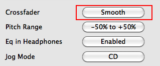

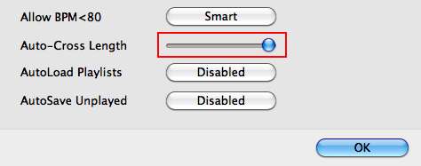

You maybe switch your crossfader function off or cut thats why transition is not smoother or slower, try to set in smooth and have a longer transition. Try this combination below and see how it works:
Posted Tue 25 Sep 12 @ 8:47 am
Thanks so much. Really appreciate that screenshot! I made those changes, but it still seems to transition too fast.. thoughts?
