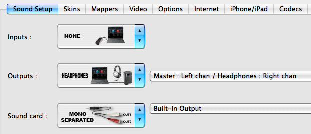

If you want to work it correctly you need the VDJ v7 pro version then map your controller and connect it via USB to your macbook pro to fully control the VDJ funtions. Then you have to set your headphone in the VDJ sound config to select the proper channel for your headphone. If you select your macbook headphone out therefore you should set and select that in your VDJ advanced sound config and select your built-in macbook soundcard as your headphone.
Using your built-in 3.5mm macbook headphone out jack like the way you wanted will work on mono split channel, your master out will be the white RCA (assigned Deck A) and your heaphone will be the RED RCA or (assigned as Deck B). But you have to setup in VDJ sound config by selecting your soundcard with mono split channel (that is with pictos that shows Speaker on the other side and Headphone on other side). See the screen shot below.
