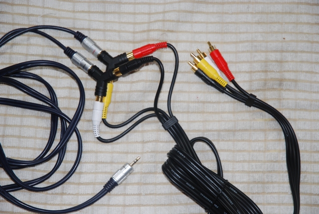

Hey guys, thanks for your feedback. Yes im baffled as the leads im using are fine in my Acer laptop. I have played 3 gigs so far and no issues. Im using the same mixer(behringer vmx1000) but with my Toshiba laptop(back up laptop) this issue with the sounds coming out of both channels. i have attached pic of the leads im using.
1-mini jack lead coming out of the headphone socket on laptop
2-The phono ends going into 2 x 3-way phono adaptors
3- which are connected to the 4 x way phono leads..
4- the 4 phono leads on the end are put into (2) into ch 1 and then (2) into ch 2 on my mixer..
two of my dj friends are using this same set up with no probs so im not sure what the issue is...is it something not ticked in the control panel..mmm..Hope someone can help..

What a mess!
It'd be far better to buy a proper four channel (two channel stereo) sound card such as a MAYA 44 USB, and simply run the four phono cables out from that.
The way you're doing it now is not only messy and confusing, but you've only got mono sound!
Using an ASIO card will also give you higher quality audio and lower latency.

It's possible that the computer you are having problems with has some sort of virtual surround sound effect enabled on its headphone output. This gives you a surround sound effect when listening with headphones, which is great for watching movies, but not for DJ'ing where you need the outputs to be completely separate (The surround effect will result in some of the left sound being heard on the right and vice-versa.)
Check in your sound card's control panel to see whether you can disable this option and set it to plain stereo sound.
However, as above, for best results, you should ideally upgrade to a proper dedicated DJ sound card that has multiple outputs such as Numark DJIO, Maya44 USB, Hercules DJ Trim, etc. This will allow you to output the sound from each deck in stereo rather than mono. An external DJ sound card will also usually be higher quality than that built into your computer.

RESULT...thanks support staff, yes i went into the sound from a right click on the desktop tab and clicked properties, from there i clicked enhancements tab then un-ticked headphone virtulization which is in the small box and then restarted and boom all good..
thanks everyone for your messages, good to see we can help each other out..Keep Rocking...
