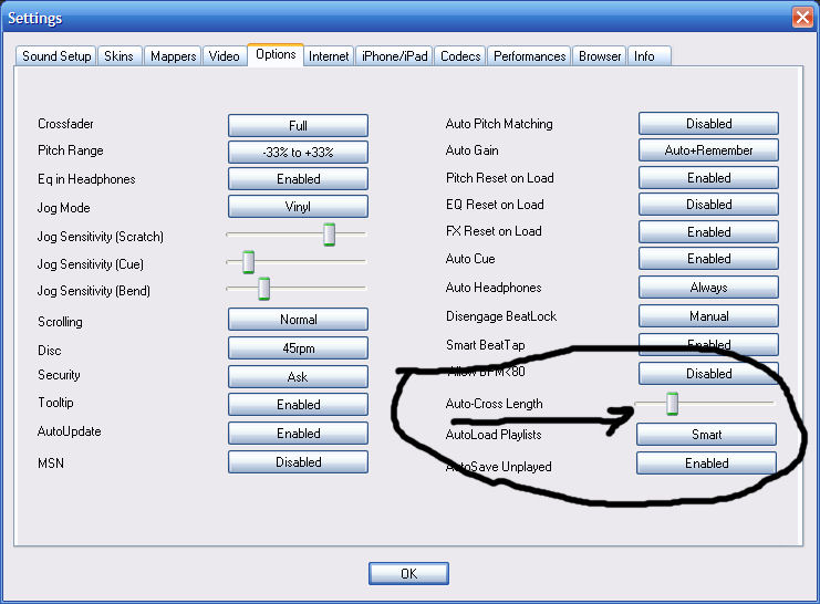

go into your configuration settings for VDJ and under the options tab on the lower right look for the automix crossfader length slider - you can adjust length of crossfade there.
right click automix playlist management for this menu and find the type of automix you want.
fiddle around with the settings till you find the combination you are most comfortable with.

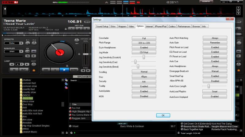

please see my settings, can\'t figure out why my playlist is not autobeatmatching? The Disable/enable autobeatmatching icon is highlighted color \"green\". The Automix type is :Smart [will be:fade]

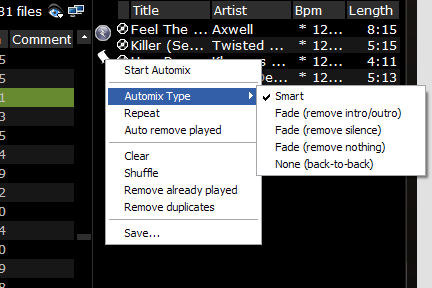

have you actually turned on automix? it will load two waveforms on the one deck. to enable it press the circle button to the top right of the playlist area and it will turn green or you can use the keyboard shortcut [ctrl + spacebar]
If you want the automix to happen over two decks you can map "automix_dualdeck" to a key on your keyboard but this is depreciated and has not been supported for many years as most prefer the current method of using only one deck leaving the other free to take over mixing again. Other than that I don't know as I never use automix ;-)

Yes, I think I have automix turned on as mentioned in my earlier post:
on my interface it's the circle above the Playlist Management icon on the top left of the playlist? So if all is correct on my end then I am wondering if this is the problem? "The Automix type is :Smart [will be:fade]
whay is that showing as "will be fade"?
