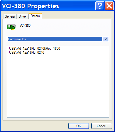

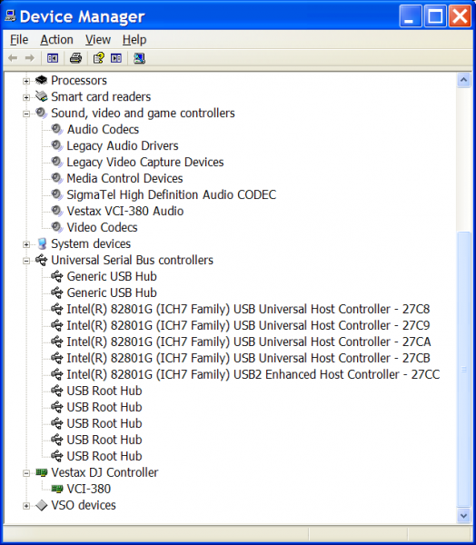

Followed some of the advise in the recommended thread to get the PID and VID sorted (That was useful info). But vDJ still does not recognize the vci-380.
Followed another thread's advise to remove the "lowerfilters" data from the registry.. no luck. What strikes me is that the MidiTrace utility can see the device and communicate with it.... even tracing messages coming back from the unit when you press buttons etc. So that to me means that the OS is communicating with the device over MIDI.
Don't understand why then vDJ does not see it as a connected device. When vDJ starts up, in MidiTrace you can see it send what looks like the sendsysex INIT command and a reply comes back.

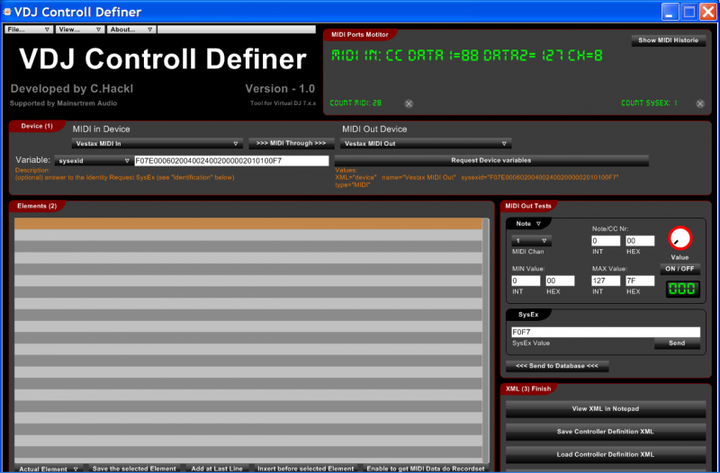

I just use chackl's amazing definer tool to get the device properties as it is done in a couple of clicks, then construct the rest of the xml in notepad as it's easier to modify then chackl's tool.

Posted Tue 17 Jul 12 @ 12:29 pm
Thanks very much synthet1c ! That's very helpful. I'll give C.Hackl's tool a try.
Posted Tue 17 Jul 12 @ 3:27 pm
Still no joy.
The Controll Definer utility returned the same sysexid I was trying to use before and got no values for the pid or vid. Following are the headers from each file and I am thinking should be enough to identify the device to vDJ. The thing is that the MIDI tools like 'miditrace' and 'controll definer' seem to have no problem seeing the controller and all messages can be seen clearly in these tools. So not sure why vDJ doesn't at least see the device.
Any ideas welcome. Thanks

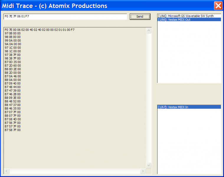

I am attaching some pictures to this post in case anyone has any additional pointers or is interested in seeing how the info from the controller shows up.

I don't know if it's just me but whenever I try to use a comment tag it always stops the definition from functioning, but even without the comment tag <!-- --> vdj still ignores the text... That said this comment tag will make vdj skip the button, so you should remove it...
<!-- <button note="0x0C" name="SHIFT" channel="0" /> -->
Also to test leds you can use chackl's tool, if you look on the right in the middle choose the correct channel and note for the led then you can press the on/off button or move the slider if you want to test the jogs led ring.
And the sysex isn't the same as Chris gave you sysexid="F07E??060200400240020000????????F7"

Right Syntet1c,
I also notice the weird behavior using the comment tag. It seems that if I have just one comment tag around a normal definition string, vDJ recognizes the controller. As soon as I use another comment tag around a 2nd definition string, the controller is not recognized. I think that was part of my problem in the beginning until SBDJ suggested that there may be some bad syntax.
Now that I have stripped things down, I also tried cstoll's sysex value, "F07E??06020040024002" but sadly it does not seem to make a difference. I have removed all suspect comments and tried the sysex value multiple ways including the one given by chackl's tool (F07E0006020040024002000002010100F7) but no luck.
I used Chackl's tool to send a note to the controller to light an LED and it works just fine.
I am not sure I understand what you mean by needing a 0 attribute in every definition. Do you mind explaining a little more?
Thanks
Thanks
What I gave did make a difference because it solved your first problem, which was the controller wasn't being seen. And, it had nothing to do with reverting to the name being VCI380. The only reason I did that is because when it comes to programming and using key elements that provide a link between things spaces and long strings can become problems very easily. The 'keep it simple' approach is always better.
As for the SysExIDs --
There is no difference between the 2 IDs from VirtualDJ's perspective because everything after the last 2 hex values are either zeros or wildcards until you get to the closing hex value of F7. However, with what you are using if there is a firmware change that changes one of the 4 zeros that you left in - then your definition/mapper will break and not function.
Additionally, since you don't fully understand yet what you are looking at - I recommend you not try and copy/paste from another definition file like the VCI-400. I would stick to just getting the controller to recognized all the elements of the controller. Start with buttons, then move to sliders, then to encoders and then jogs.
And leave your mapper file empty - do not write anything directly in it. Modify the device file with new elements. Open VirtualDJ. Go to the mapper tab and start interacting with those elements to add them to the mapper interface. If you defined it properly you will see it show up and can map a funtion to it. If you didn't get it right - it won't show up.
About comments - the definition/mapper files are not traditional XML documents. And you can not treat them as such. A less than '<' and greater than '>' symbol means something to VirtualDJ. So remove the comment tagging. Also, if you don't want something to be parsed - don't put it in the file.
And one small note ... and why I said you needed to keep all your questions in 1 thread ... looking at the VCI-380 documentation they tell you the channels that the elements are on. Confirm with the miditrace tool that what they are telling you is true. For example if the Crossfader is on channel 8 then the miditrace tool should show series of midi codes starting with - B7 ## ## - in miditrace when you move the crossfader. If that is the case, then you need to use channel="7" in the definition - not '8'.
good luck!
