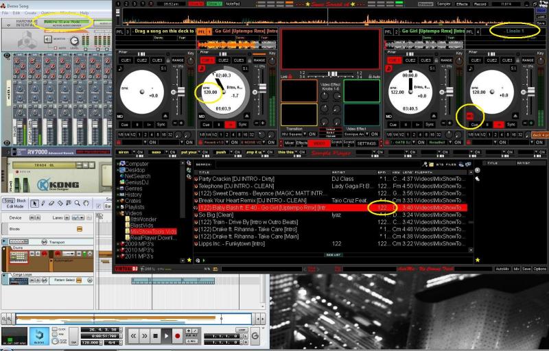

I think you forget VDJ will sync in two different ways................1 being that it uses the grid and 2 it will match the tempo of the other track (which is how I beleive it sycns from a line-in)
As you can see in my picture I have deck 4 as my MASTER deck (playing) and I hit sync on deck 1 and it matched up to deck 4 which is the deck I have REASON playing through.........NOW I drop the beat in myself so it does match up..........but if I tried to use "Sync_play" I dont think itd work cause there is no grid for it to match up too..............
Alls I can say is to try it yourself and youll see it VDJ will MATCH the BPM of the REWIRED deck, now yes mine does fall out of sync but not as fast as the OP.............
