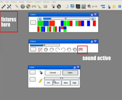

There are some works to be done before you can see they're all sync together. First you have to set the DMX channel address in the 512 univers of your freestyler, then again add the fixtures you must see to it that your software are recognizing your fixtures everytime you add them and define the DMX address. Can you post here the steps you did setup your fixtures from connection up to the DMX addressing and fixture profiles programing you maybe missed a steps thats why you wont be able to get it working. You maybe missed to set the sound active mode on your freestyler. On your freestyler "WINDOW" drop down menu choose "ALL" then it will display all the necessary windows for editing your fixture like the picture below the red square mark as the sound active mode for your fixture click that and try tapping your lights as it react according to the sounds receive by your fixtures.
Try one fixtures first to see if it works then just add another fixture again.
