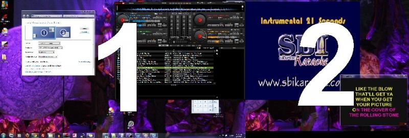

I was on the same page as you and made a skin that spans 2 screens and it totally works b.t.w.! I positioned my 2nd monitor to the right of my main monitor and placed VirtualDJ between the two. The main karaoke window can now go on a third monitor! Vuala, done!!
