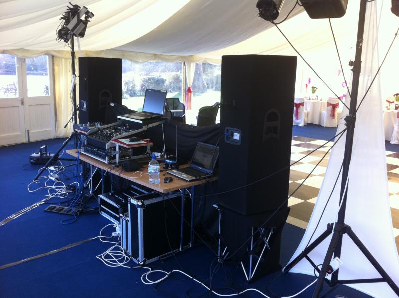

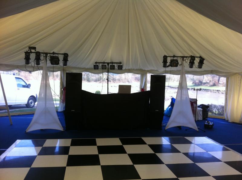

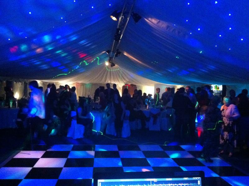

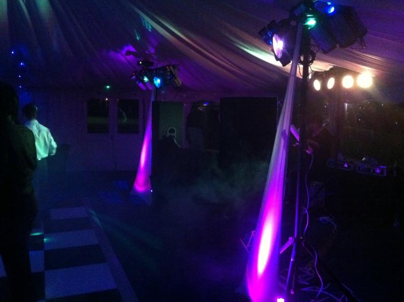

as said above, there are no rules for and against lighting, it\\\\\\\'s all about fitting it in with your needs and the design ideas of your \\\\\\\"Show\\\\\\\".
all mine are DMX controllable and the entire package has cost me less than £700 in total, 4 scanners, 2 barrel, 2 mutliplex and a laser
also a fogger for effect :-)
also in the background a par bar for flood \\\\ first dance

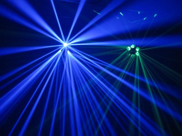

I'm going to suggest the opposite :) - welll kind of, anyway
If you think your mobile gigs are going to be you alone, I would suggest effects that:
1. Look good by just tuning them on
2. Don't require to run as pairs to look good
3. Don't require dmx to look good
4. Always work (obviously)
5. Don't consume a lot of power
You don't really have time to mess with the lights ones you've put them up - you are busy djing - and power can always be an issue when you mobile DJ in weird places
So I would go for good looking stand-alone effects that use LED as light source
I'm not saying that they shouldn't have DMX - only that they should be good looking without it. If you plan to expand to do two-people gigs, where one in in charge of the lights, or plan to use your lights more creatively, then DMX is the way to go
All my lights look great running on programs or sound control, and they are all "big lights" in the sense, that 2 of them is enough to light up an avg sized ballroom. I normally bring 8 on two stands, and mix between them, so only 2 or 4 of them are runing at any given time. This really just requires that they are lights with lots of beams at the same time and a big coverage angle
Like I said: Alway choose LED's, and mix between ones that have a motor in them, so that the light moves around in normal movements, and the ones with a lot of static dots that just gets turned on and off in patterns
Other than that, look at the unit. Does it look professioinal or does it look like a toy? To me it's important that the units looks professional when they are not running and the house light is still on during dinner - If they look good both on and off, it doesn't matter that you got them cheap :)
So they don't have to be expensive. American DJ makes ok stand-alone lights. You can look them up on youtube to see what they look like running, and to see other peoples comments on them
Regarding fog, I would go with a Hazer. It chops up the fog and releases it slowly, so you don't blast it in to the room (women especially seem to hate that), and make less smoke looks just as look

even though i have listed all mine seemingly in pairs, they are all capable running independently and without the need for computer DMX control,
images shown above were of a wedding gig done in march last year, and an all day event which gives me the time to set up, and sort control options for the lighting
yet the whole basis of the system is that it can be broken down depending on the event and used as per requirements..
at the end of the day, the target audience is what you should be basing your needs on,
every-opinion counts, but none should be seen as the answer to all your questions
you seem to have mis-interpreted my post :-)
was not inferring that he should / shouldn't have certain types of lights, merely that it's whatever he deems suitable for his show, and by his show i was not suggesting that it's all about him, mores his business target,

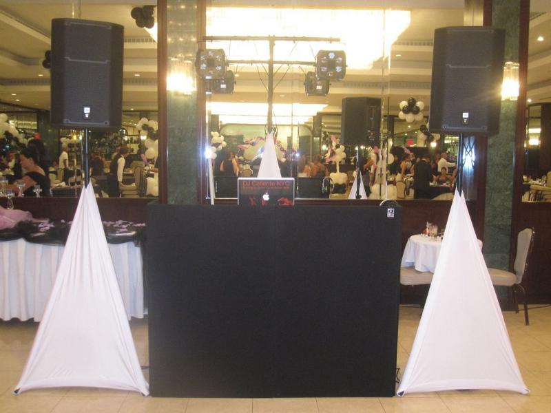

i would buy these :-D

Renegade- I really like the look of your setup, in fact I might imitate your tripod flood light setup with my megapixel. I am just curious though why didn't you hide your wires better? Is it because they weren't long enough. The rest of your setup is so clean and your scrims look great, seems like a shame to have cables sticking out.
I noticed that too! I was biting my tongue, trying not to comment in case it caused offense... :-)
Far better to run your cables carefully along the rear of the T bar and the tripod, using velcro ties (or electrical tape if you're cheap!).
Posted Tue 27 Mar 12 @ 1:04 pm
all criticism is good, and certainly wouldn't have caused offense.. lol
that was purely just after rigging in and was eager to get it on camera, all cables were hidden and run along t-bar before any arrivals at 2pm.. :-)
behind was even worse.. :-) but all was tidy before showtime, lo
l
have since changed a lot of the behind the scenes systems though yet the one constant remains......... VDJ
l

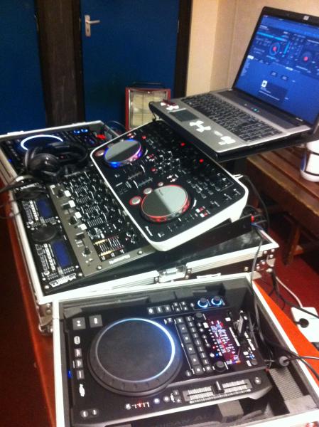

mission control from behind the scenes now runs with this, and of course the other laptop running the lighting systems
