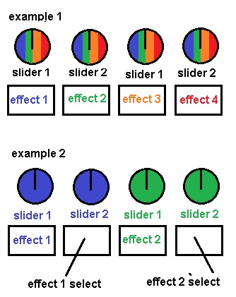

I am using an MC6000 and I am wonder if there is a way of differentiating between the active effects.
I am using my efx 4 buttons to activate efx 1 2 3 4. In my workflow i usually use max 2 effects at a time. So what i want to do is have efx knobs 1 and 2 modify the first active effect parameters 1 and 2 while knobs 3 and 4 would modify the second active effect's parameter 1 and 2.
Ideally it would be something along the line of:
efx knob 1
deck left active effect 1 slider 1
efx knob 2
deck left active effect 1 slider 2
efx knob 3
deck left active effect 2 slider 1
efx knob 4
deck left active effect 2 slider 2
So bottom line is there a way to script it so that vdj can tell the difference between the active effects independent of their slot?

hey bro, I can think of a couple of ways to do it but need a little more info on how you want it set up, You will obviously be using cds4 for the skin which has 4 effect slots so I would think you would want to use the first example as this will use the four slots on the skin, there is hoever a couple of problems I can think of off the top of my head, the main one being that if you for instance have 3 effect slots active, due to the nature of the mapping the knobs will default to the first two effects in the script...
the second way is simpler to do because you can only choose from two slots so there will be no confusion in the mapping, you could also map the second button to select different effect, of effect pairs.. so I think would be much cleaner, but you would lose the functionality of the skin's slots 3 and 4, but you could probably remap the skin to show the effect slider name instead of the effect slot name..

also something else to consider and my prefeered way of doing it is having multiple parameters on a single knob, it does restrict the sound you can make, but it is much silmpler to achieve and you really shouldnt be mixing with effects that much to notice...

the easiest option I can think of is not naming the effects in the different slots, so on the knobs you would map
knob 1
effect 1 active on ? effect 2 active on ? effect 1 slider 1 : nothing : nothing : effect 1 active on ? effect 3 active on ? effect 1 slider 1 : nothing : nothing : effect 1 active on ? effect 4 active on ? effect 1 slider 1 : nothing : nothing : effect 2 active on ? effect 3 active on ? effect 2 slider 1 : nothing : nothing : effect 2 active on ? effect 4 active on ? effect 2 slider 1 : nothing : nothing : effect 3 active on ? effect 4 active on ? effect 3 slider 1 : nothing : nothing : effect 1 active on ? effect 1 slider 1 : effect 2 active on ? effect 2 slider 1 : effect 3 active on ? effect 3 slider 1 : effect 4 active on ? effect 4 slider 1
knob 2
effect 1 active on ? effect 2 active on ? effect 1 slider 2 : nothing : nothing : effect 1 active on ? effect 3 active on ? effect 1 slider 2 : nothing : nothing : effect 1 active on ? effect 4 active on ? effect 1 slider 2 : nothing : nothing : effect 2 active on ? effect 3 active on ? effect 2 slider 2 : nothing : nothing : effect 2 active on ? effect 4 active on ? effect 2 slider 2 : nothing : nothing : effect 3 active on ? effect 4 active on ? effect 3 slider 2 : nothing : nothing : effect 1 active on ? effect 1 slider 2 : effect 2 active on ? effect 2 slider 2 : effect 3 active on ? effect 3 slider 2 : effect 4 active on ? effect 4 slider 2
knob 3
effect 1 active on ? effect 2 active on ? effect 2 slider 2 : nothing : nothing : effect 1 active on ? effect 3 active on ? effect 3 slider 2 : nothing : nothing : effect 1 active on ? effect 4 active on ? effect 4 slider 2 : nothing : nothing : effect 2 active on ? effect 3 active on ? effect 3 slider 2 : nothing : nothing : effect 2 active on ? effect 4 active on ? effect 4 slider 2 : nothing : nothing : effect 3 active on ? effect 4 active on ? effect 4 slider 2 : nothing : nothing : effect 1 active on ? effect 1 slider 4 : effect 2 active on ? effect 2 slider 4 : effect 3 active on ? effect 3 slider 4 : effect 4 active on ? effect 4 slider 4
knob 4
effect 1 active on ? effect 2 active on ? effect 2 slider 1 : nothing : nothing : effect 1 active on ? effect 3 active on ? effect 3 slider 1 : nothing : nothing : effect 1 active on ? effect 4 active on ? effect 4 slider 1 : nothing : nothing : effect 2 active on ? effect 3 active on ? effect 3 slider 1 : nothing : nothing : effect 2 active on ? effect 4 active on ? effect 4 slider 1 : nothing : nothing : effect 3 active on ? effect 4 active on ? effect 4 slider 1 : nothing : nothing : effect 1 active on ? effect 1 slider 3 : effect 2 active on ? effect 2 slider 3 : effect 3 active on ? effect 3 slider 3 : effect 4 active on ? effect 4 slider 3
the idea is if you have 2 effects active you get the use of the first two sliders, if only one effect is active you get the use of 4 sliders... you coud probably do something with the leds for the effect activation buttons so if three effects are active the led could blink to let you know

I tried out the knobs... it needs the "nothings" deleted, and works great with 2 effects active, but not sure how to make it work with only 1 effect active... it doesn't need the grey bit, that is what I was using for the single effects
effect 1 active on ? effect 2 active on ? effect 1 slider 1 : effect 1 active on ? effect 3 active on ? effect 1 slider 1 : effect 1 active on ? effect 4 active on ? effect 1 slider 1 : effect 2 active on ? effect 3 active on ? effect 2 slider 1 : effect 2 active on ? effect 4 active on ? effect 2 slider 1 : effect 3 active on ? effect 4 active on ? effect 3 slider 1 : effect 1 active on ? effect 1 slider 1 : effect 2 active on ? effect 2 slider 1 : effect 3 active on ? effect 3 slider 1 : effect 4 active on ? effect 4 slider 1
effect 1 active on ? effect 2 active on ? effect 1 slider 2 : effect 1 active on ? effect 3 active on ? effect 1 slider 2 : effect 1 active on ? effect 4 active on ? effect 1 slider 2 : effect 2 active on ? effect 3 active on ? effect 2 slider 2 : effect 2 active on ? effect 4 active on ? effect 2 slider 2 : effect 3 active on ? effect 4 active on ? effect 3 slider 2 : effect 1 active on ? effect 1 slider 2 : effect 2 active on ? effect 2 slider 2 : effect 3 active on ? effect 3 slider 2 : effect 4 active on ? effect 4 slider 2
effect 1 active on ? effect 2 active on ? effect 2 slider 1 : effect 1 active on ? effect 3 active on ? effect 3 slider 1 : effect 1 active on ? effect 4 active on ? effect 4 slider 1 : effect 2 active on ? effect 3 active on ? effect 3 slider 1 : effect 2 active on ? effect 4 active on ? effect 4 slider 1 : effect 3 active on ? effect 4 active on ? effect 4 slider 1 : effect 1 active on ? effect 1 slider 3 : effect 2 active on ? effect 2 slider 3 : effect 3 active on ? effect 3 slider 3 : effect 4 active on ? effect 4 slider 3
effect 1 active on ? effect 2 active on ? effect 2 slider 2 : effect 1 active on ? effect 3 active on ? effect 3 slider 2 : effect 1 active on ? effect 4 active on ? effect 4 slider 2 : effect 2 active on ? effect 3 active on ? effect 3 slider 2 : effect 2 active on ? effect 4 active on ? effect 4 slider 2 : effect 3 active on ? effect 4 active on ? effect 4 slider 2 : effect 1 active on ? effect 1 slider 4 : effect 2 active on ? effect 2 slider 4 : effect 3 active on ? effect 3 slider 4 : effect 4 active on ? effect 4 slider 4

I got inconsistent behavior with this script. I also feel like it shouldnt be this complicated.
Is there really no way of differentiating between 2 active effects independent of which slot they are in?

not that I can think of, what the script is doing is asking about
1-2
1-3
1-4
2-3
2-4
3-4
that is all the combinations you can have with the 4 effects having two activated at a time.. I also tried to include single effects active at the end, but giving the use of all 4 sliders, that was the part I had trouble with...
