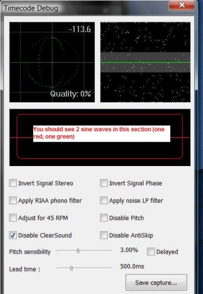

Oh yeah, sorry. I forgot you can see it better in the 'debug' window.
http://dl.dropbox.com/u/56102380/DJ%20DOCUMENTS/virtual%20vinyl%20time%20codes%203.jpg

This does not look like a perfomance issue to me, more like a physical problem with the signal from the TC source.

Agreed - that timecode signal is completely messed up, it's not a VDJ setting issue, it's a problem with the signal that VDJ is recieving from your sound card.
Looks like intereference or distortion of some kind, so start with the basics and work from there. Check your cables. Play an audio CD and try and record the input etc.

So it means there is no signal in the line-in and consequently no signal to analyse by the software.
However, the light circle in the above section could mean the software detects the noise of {computer + timecode}. I'm wondering if the volume of the line-in is off?
