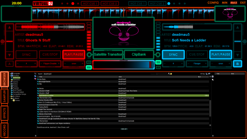

I'm back... at least for this release ;-)

hi cbgraphix,
nice one...
to big for me but i tried it on my homepc.
ps: I think you forgot to type the decks for the pitch-sliders in the xml.
You had this line in your xml:
<slider action="pitch" deck="right" dblclick="deck right pitch 100%" orientation="vertical" direction="up">
I changed it for this and it works:
<slider action="deck right pitch" dblclick="deck right pitch 100%" orientation="vertical" direction="up">
also for deck left offcourse..
best regards,
John
nice one...
best regards,
John

That would be the way the Jeremy's Skin Creator coded it. Didn't realize it wasn't working, will have to check that.

I'll check that in the Skin Creator too. ;)

Well, the code SHOULD work, it's telling it what deck to use but it's opperating off of the default deck so I will update the source files to include those corrections... thanks for the feedback.
