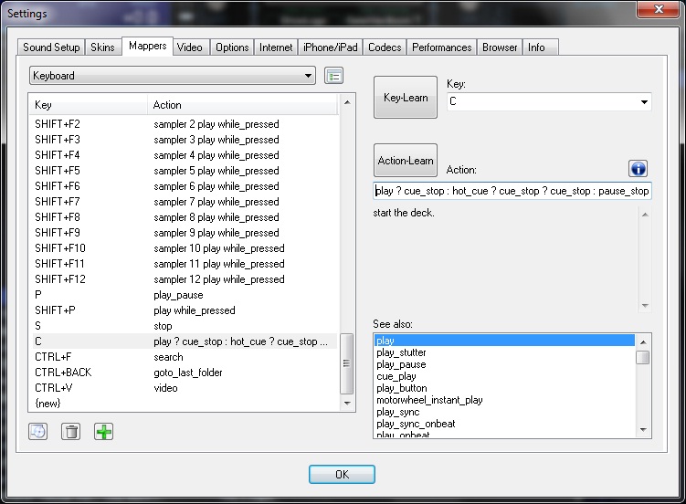

If you have a controller you can map this to the cue button to stop cue 1 being overwritten if it already exists:
play ? cue_stop : hot_cue ? cue_stop ? cue_stop : pause_stop : cue_stop

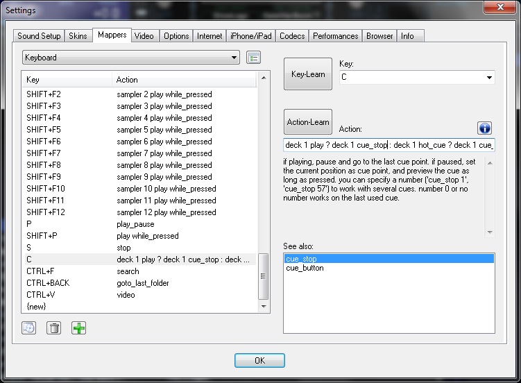

If you're skin only then the cue command can be changed to this (all you need to do is change the deck number accordingly)
deck 1 play ? deck 1 cue_stop : deck 1 hot_cue ? deck 1 cue_stop ? deck 1 cue_stop : deck 1 pause_stop : deck 1 cue_stop

Thanks mate - depending on the club/room i\\\'m in, I\\\'m, using either CDJ2000, CDJ850 or AA DP2 controllers.
Here at home it\\\'s just the skin, so this is what I\\\'m experimenting on.
So I\'ve pasted that string into the cue command as per the screen grab - it doesn\'t work. Cue point 1 gets over written if you pause, and then press cue.
Cheers

Try the first one, the one you've tried is for skins not mappings.
It definitely works, I have used these strings for months.
