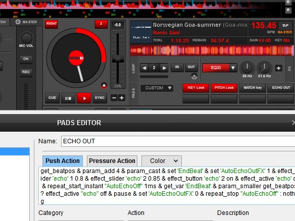

Loco did a fine job explaining the code.
Some remarks:
I used the above code for my own custom mapper and I just copy/paste it here, forgetting to mention three things:
1) I always have the trail on 'Echo' and 'Reverb' activated.
2) I always use 'Echo' with 1 beat timing.
3) Since this script is used on a controller it also turns on/off a led for the FX ( the 'unused' variable Loco found on script)
Now for the script itself:
You can adjust the length of echo by using effect_slider 'echo' 2 and_a_value
However you would want to adjust the 'EndBeat' as well, because otherwise you would stop the deck before you feed the echo with all beats.
SO, the full code for 1 beat echo out should be:
get_beatpos & param_add 1 & param_cast & set 'EndBeat' & set 'AutoEchoOutFX' 1 & effect_slider 'echo' 1 0.8 & effect_slider 'echo' 2 0.65 & effect_button 'echo' 2 on & effect_active 'echo' on & repeat_start_instant "AutoEchoOff" 1ms & get_var 'EndBeat' & param_smaller get_beatpos ? effect_active "echo" off & pause & set 'AutoEchoOutFX' 0 & repeat_stop "AutoEchoOff" : nothing
For 2 beats it should be:
get_beatpos & param_add 2 & param_cast & set 'EndBeat' & set 'AutoEchoOutFX' 1 & effect_slider 'echo' 1 0.8 & effect_slider 'echo' 2 0.75 & effect_button 'echo' 2 on & effect_active 'echo' on & repeat_start_instant "AutoEchoOff" 1ms & get_var 'EndBeat' & param_smaller get_beatpos ? effect_active "echo" off & pause & set 'AutoEchoOutFX' 0 & repeat_stop "AutoEchoOff" : nothing
For 4 beats it should be:
get_beatpos & param_add 4 & param_cast & set 'EndBeat' & set 'AutoEchoOutFX' 1 & effect_slider 'echo' 1 0.8 & effect_slider 'echo' 2 0.85 & effect_button 'echo' 2 on & effect_active 'echo' on & repeat_start_instant "AutoEchoOff" 1ms & get_var 'EndBeat' & param_smaller get_beatpos ? effect_active "echo" off & pause & set 'AutoEchoOutFX' 0 & repeat_stop "AutoEchoOff" : nothing
Finally for the led of the button you need to simply use:
var 'AutoEchoOutFX'

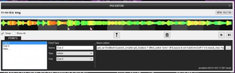

@PhantomDeejay
Now I find that these scripts does not allow you to paste in POI editor after you copy it. Worked fine before.
Help.
Help.
try copy and paste this, anyone?
Posted Sun 24 Jul 16 @ 1:37 pm
working fine here
Posted Tue 26 Jul 16 @ 11:00 am
PachN wrote :
working fine here
I am disappointed it does not work for me. I really need to apply this script. Other scripts I am able to copy and paste in POI Macro Action no issue as the below pic shows. The script in question I even copy it and paste into a word document and then copy from the word document and try to PASTE it in the POI Macro Action .. when I right click on the mouse no paste option is available. Use different mice and computers .. same result.
Posted Tue 26 Jul 16 @ 1:32 pm
After trial and error I get it to work. This is how I had to do it: Copy line 1 paste, copy line 2 paste , copy line 3 paste and so on. Before I could have copy the whole script in one shot and paste it. Problem with this copy line by line is that if I miss it by a space when I paste it,I am $crewed!.
Posted Tue 26 Jul 16 @ 4:48 pm
There is a copy and paste bug in the current build.
Just roll back to a random build 2828.1112 and as you guess, copy the whole script and paste in Macro Action works smoothly.
Posted Tue 26 Jul 16 @ 7:08 pm
CTRL-V can be used instead of paste. Works perfectly here, many thanks.
Posted Tue 26 Jul 16 @ 10:09 pm
So you just tried it with the mouse not with CTRL-V?
Because I only did CTRL-V.
Posted Wed 27 Jul 16 @ 9:50 am
yes!!
thanks guys, CTRL-V ... got it.
Posted Fri 29 Jul 16 @ 2:05 pm

Using this automated echo efx script seems to be a nice alternative for a loop out effect. It's just after I make customize buttons for each deck using the script below in VDJ8. Each button then does not function independently after I assign each deck to two different keyboard short cut to activate the efx on deck A or deck B. How do I assign this efx to only activate deck A or B, and not affect them both simultaneously when using this automation script. Thanks in advance..
Posted Mon 02 Jan 17 @ 1:12 am
@ DJTUC
add the below script at the beginning while creating the mapper, the below scrit will allow each deck work independently, even when you assign the scripts for both decks on just one keyboard number or letter..
deck active select action_deck1 ? actionA : actionB' true
let me know if it works for you, if not, just send me the code like you have inserted and let me know what version of VDJ & Controller you have at the moment..
Posted Wed 04 Jan 17 @ 6:40 am
@ Dj Nobel Prince
I tried your suggestion, when I append the script at the beginning of this automation scrpit it doesn't work. When I remove it the echo effect works & by the way the version I'm testing this effect on is VDJ 8. Here's how the scipt Im using looks...Thanks for your help..
deck active select action_deck1 ? actionA : actionB' true get_beatpos & param_add 1 & param_cast & set 'EndBeat' & set 'AutoEchoOutFX' 1 & effect_slider 'echo' 1 0.8 & effect_slider 'echo' 2 0.65 & effect_button 'echo' 2 on & effect_active 'echo' on & repeat_start_instant "AutoEchoOff" 1ms & get_var 'EndBeat' & param_smaller get_beatpos ? effect_active "echo" off & pause & set 'AutoEchoOutFX' 0 & repeat_stop "AutoEchoOff" : nothing
Posted Wed 11 Jan 17 @ 1:50 am
@ djtuc
Ok.. I will try out something this weekend and update you with a solution... one love
Posted Thu 12 Jan 17 @ 9:03 pm
putting d deck number infront of d code helps specify d deck I wanna trigger d echo out on instead of active deck......deck 1 THE CODE works for me______Thanks for solving dz ish
Posted Fri 13 Jan 17 @ 7:52 am
