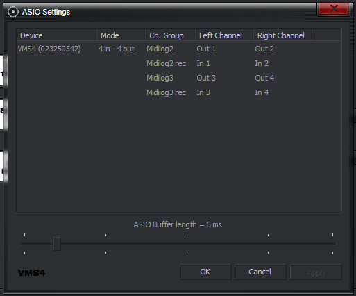

ok I just got the vms4.1 about a week go I just got me a turntable and timecode I tried to follow the directions I found here in the forum but when I did tho's settings I couldn't get no more sound out of my vms I can hear the sound of the timecode coming out of my speakers but virtual dj is not showing anything in the setup for timecode i am using serato scratch live vinyl cvo2 is what I have it set to but nothing is showing up and I can now hear my computers sound running threw the vms4 to my speakers is this so post to happen or am I just doing it all wrong :(

You need to have the VMS4 to 4out mode.
Connect your RCAs to midilogs 2 and (or) 3
Make sure those are on USB mode. The midilogs 1 and 4 should be on Analogue
Inputs Timecodes
Outputs Ext mixer
Sound card ASIO ..VMS4

yes thats what I have I hear the noise from the vinyl coming threw my vms4 but virtualdj is not picking it up :(

Choose ASIO in Sound cards.. Press the ASIO config button. It will open the AA Control panel. Make a screenshot and post here.
Posted Wed 08 Aug 12 @ 7:21 pm
