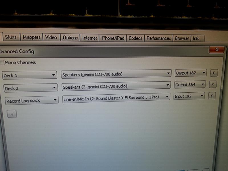

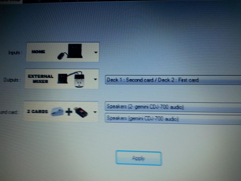

\\\"not working consistentl, what I mean is it does not always find the cdjs 700s\\\'
I had a friend of mine finally fix the issue.
Here some pictures of I finally to work perfectly every time now.
Thanks again for your help
Scotty
Scotty
Posted Mon 28 Oct 13 @ 2:38 pm
Using the WDM drivers (as per the pictures above) instead of the ASIO drivers will not provide you the ability to set the latency to low values. For non-scratching djs though, this may be minor.
Posted Mon 28 Oct 13 @ 9:32 pm
Only way to make it work consistently, at least with my set up and lantecy is not a problem, have a very powerful laptop. Thanks for the heads up about the scratching thing, have had no problems with that as of yet,(I do not do much myself-but guest that come over have tried scratching no issue so far. Thanks again for you help . have a blessed day
Posted Tue 29 Oct 13 @ 7:55 am
