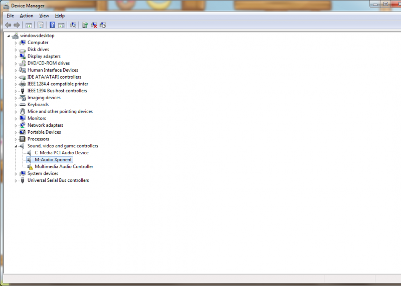

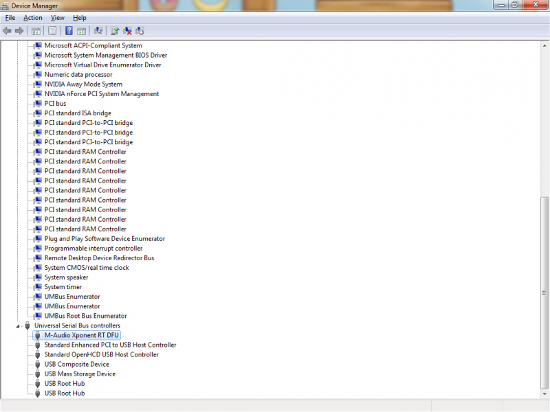

Shouldn't there be another device too - DFU rings a bell.
Posted Wed 21 Sep 11 @ 1:57 pm
might be, i have no clue

Posted Wed 21 Sep 11 @ 2:26 pm
have you updated driver if not go here http://www.m-audio.com/index.php?do=support&tab=driver go= dj / xponent / your os Installer: Driver: was update on 17,02,2011.
down on your task bar is there a red dot with a white > in it as this is your m audio drive/ sound settings .
