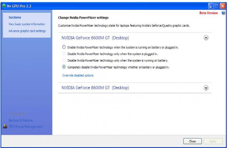

You need to completely disable the nVidia "PowerMizer" in your card with the Nv GPU Pro tool.. click on the link below...set like in the image...
Dowload link:http://www.nvgpupro.com/
Good Luck,
Joey...
Good Luck,
Joey...
Posted Thu 29 Sep 11 @ 9:51 am
Is this a windows 7 thing Joey?? I have that same card as in your picture and I've never seen that option.
Not trying to hijack, lol!
Huey
Huey
