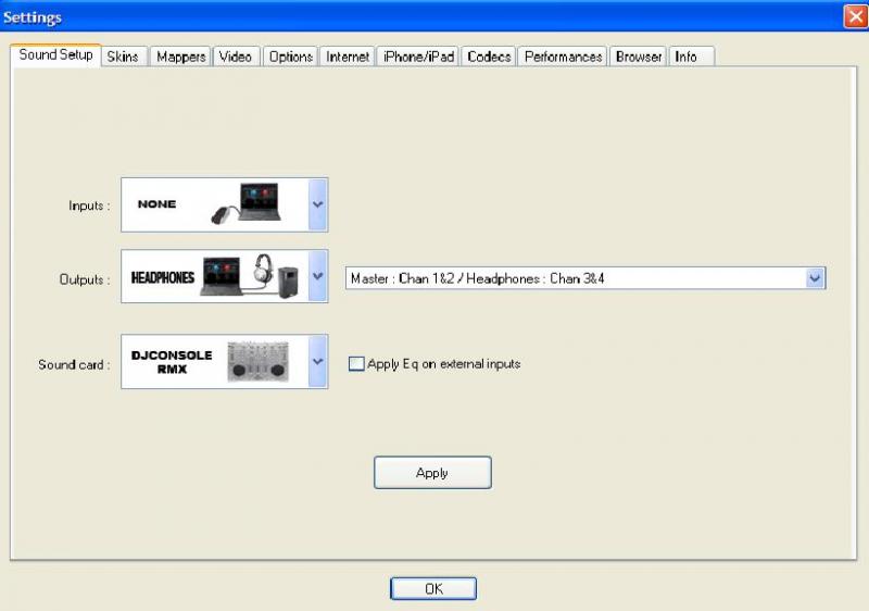

Your sound settings are incorrect - Single Output means just that - One output (Master only) with no headphone pre-listening.
Please see http://www.virtualdj.com/wiki/RMX.html on the page http://www.virtualdj.com/wiki/Controller%20Configuration%20And%20Troubleshooting.html for the correct settings.

Set it like this, you shold be fine...
