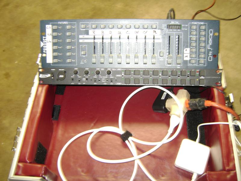

this What i Got also.

Your best bet is too get the freestyler software and a USB to DMX dongle.. or a hardware DMX controller like the one pictured above (though freestyler is cheaper and easier to program)
