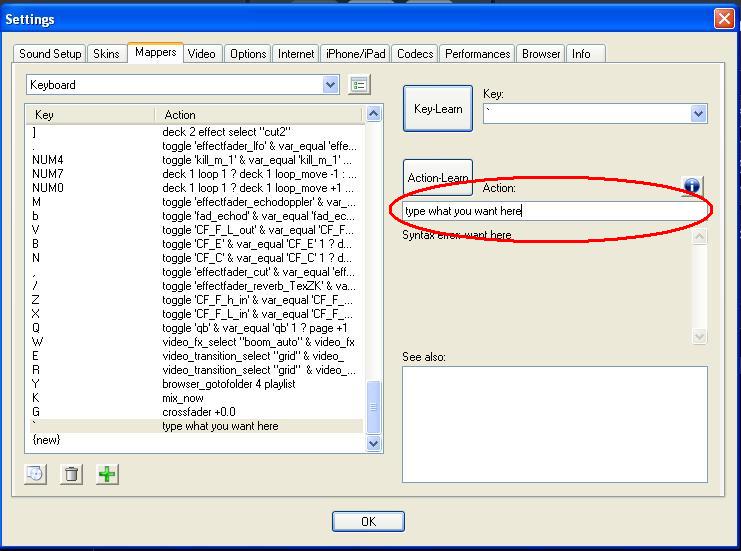

You just need to use key learn to get a button or fader to script on, then type what you want the button/slider to do, if you want a button to do more than one thing at a time use "&" eg "hot_cue 1 & loop 4" (this will go to hot cue 1 and loop 4 bars, giving you a hot loop

So I press the plus button, hit the shift (left) button on the controller, then type what you wrote as the new shift command in the auto- learn box?.....Correct?
Posted Sun 19 Jun 11 @ 6:02 am
yep just cut it from here and paste it in the action box, but just do it for one side of the controller, if you want to do anything else just use the "explanation" script and fill in what you want
Posted Sun 19 Jun 11 @ 6:16 am
iI did just as I mentioned above.....Opened Vdj, config, mappers, hit the plus button on the software mapper interface of VDJ, hit Shift button on left deck of the controller, and typed the new command for Shift as you wrote it down, into the Auto Learn box, hit ok.....Everything was fine
Followed the same process...hit plus button on software mapper interface, moved the left deck controller slider, and typed the new command that you specified for the slider, into the Auto Learn box, hit ok....nothing works...the pitch doesn't respond nor does the filter when shift is pressed along with moving the slider as it should.....
BTW....VDJ will not let me copy and paste your commands from the forum into the Auto Learn box.........Im typing them out word for word...
What am I doing Wrong....Im sorry to keep buggin you....this is sooooo frustrating!!!......thanks tho

Hey there jusblaze246,
I realize that this post is outdated but maybe someone else might be able to benefit from a solution to your problem. So I have in front of me a Hercules 4-Mx and I'm pretty sure that my solution will work for other Hercules models as well.
Let's address your first issue: Shift mappers to control both side independently.
First step is to go into Settings > Mappers > Hercules 4-Mx (or whatever you have). Next, click Key Learn and hit either of the Shift buttons on the controller.
Then for your action, you are going to put toggle "$SHIFTON"
I'm going to break this down for people that actually want to learn what this command is doing.
In VDJ Scripting, you are allowed to create/assign variables for buttons and then control the state of that variable. So in the above code I created a variable called SHIFTON (you can name it whatever you want but please remember to be consistent). In order to create a variable, just surround it with quotes. However, for this example to work properly, you will need to precede it with a $ sign. The $ makes the variable a global variable (available throughout the program) so that other buttons can now base their actions off the state of the variable.
Finally, the toggle command changes the value of the variable following it between True (1) and False (0). As long as you don't specify decks in that command for the shift button, the two shift buttons on the controller will control their respective decks independently. In other words, the left shift button will control the left deck and the right shift button will control the right deck.
Now the following syntax is specifically for the knob directly next to the Shift button so that it controls the Filter function when the shift button is off and the Key function when the shift button is on. However, the structure of the command can be applied to any other button on the controller, including the low/mid/high knobs!
Go back to the mappers, click Key-Learn, and turn that knob next to the shift key. It will turn up as FX.
Then under Action, type in var "$SHIFTON" ? key_move : filter
Basically, all this is saying is when SHIFTON is true, execute the action on the left side of the colon, and when SHIFTON is false, execute the action on the right side of the colon.
Here is the definition for var straight from virtual dj so that it may guide you for other conditional actions.
syntax: var "my_var" ? my_action1 : my_action2
execute my_action1 if my_var is true (non zero), execute my_action2 otherwise.
Hope this helped.
