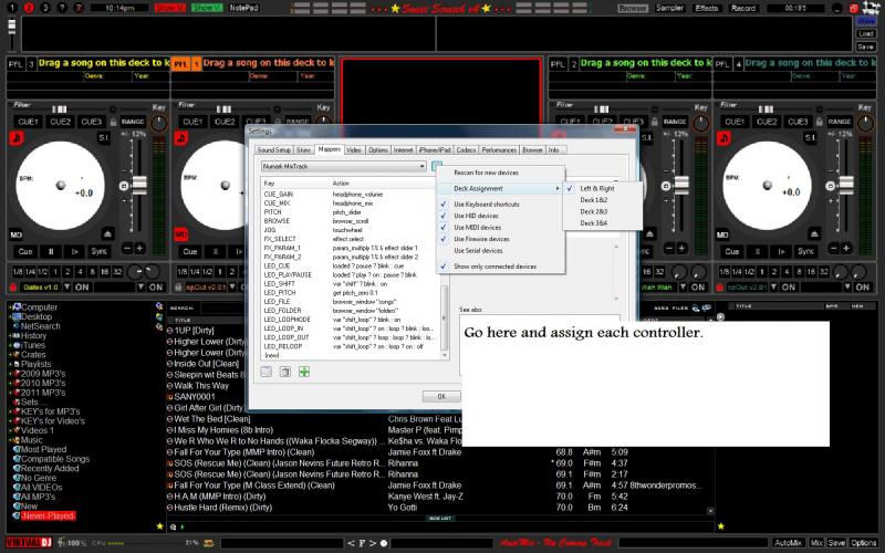

How do i set up configuration so that on deck 1 and 2 cues on one controller and deck 3and 4 cues on the other? controllers are RMX AND MK4

Here maybe this will help,
Use the upfaders and not the crossfader though and youll be good to go.
Hope that help
Huey
Hope that help
Huey

i've done that, the problem is my friend wants to monitor only 3 and 4. With that setup, its only 1 soundcard therefore all monitoring goes thru it.We have have to split headphone jack and take turns cueing. Would like to cue at same time.
