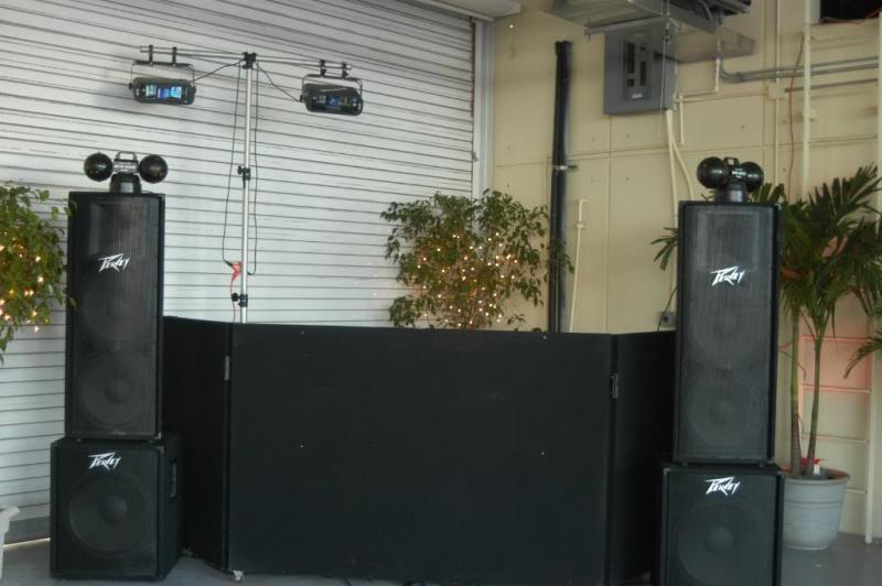

Huey, I Have the same speakers. 2- 215s and 2- 118s At first when I got that set up I ran a crossover between my mixer and my amps mids and highs to the 215s and lows to the 118s did that for a couple of years but it was a pain to lug all 4 speakers out for every gig and I also wanted the full range out of my 215s not just mids and highs. so I got rid of my crossover
I use a Samson 2400 to push my 215s @ 750 watts per side @ 4 Ohms Via the XLR main outs on my MC6000
This is a loud set up and I never have my main on the MC6000 more that 50% as well as the channel faders no more than 50% but it\'s nice to know I have the room to push much more sound into the room if I want or have to.
For larger venues when I need much more kick/ thump/bass I use a old Peavey 8.5-C to push my 118s @ 400 watts per side @ 8 Ohms Via the RCA main out on my MC6000.
So if you do get this set up thats what you want your amps to push.... 1 amp @ 750 watts per side @ 4 Ohms and 1 amp @ 400 Watts per side @ 8 Ohms
I have been a Peavey user since I started playing guitar back in......well back in the day lol
The only down side I see to my system is the weight of hauling the 4 speakers in and out. Iit is howevr an impressive site to have over 6\' of speakers on either side of you and it sounds great! I just posted some photos of my speakers in the photo contest thread that is stuck at the top of the forum.
I am also looking at going with the new 1200 watt 12\" speakers that Peavey just made super light and super loud.
Anyways good luck with what ever you choose!
Edit:
Found a old pic of the speakers for you
Edit:
Posted Sun 12 Jun 11 @ 9:10 pm
Nice setup bro!!

Hmm to do that your going to have to school yourselef in Ohms and any other technical specs that all that may involve because the 215s are 4 Ohm speakers rated at 700 watts program and the 118s are 8 Ohms speakers rated at 400 watts so that would be 12 Ohms per side or 1 Ohm per side (The Ohms are kind of greek to me) and two different wattages. I would not recomend doing it that way. I would run the 215s on one amp and the 118s on another amp.
No offence taken from the people that don't care for the Peaveys at all. I have used that Peavey set up since 2006 and have recieved many compliments on the sound from clients. For an outdoor or larger venue, that system does the job very well. So if you don't mid Lugging all that equpment around or might have a residency where you can set it up and leave it. It's a great system for being Peaveys "budget minded" line of speakers.
Now as for the Idea of two smaller powered speakers on stands and 1 or 2 powered subs. That will be my next purchase down the road. They have many options from JBL, Mackie, Peavey, QSC, RCF.... of 280 watt to 1200 watts 10, 12 & 15 inch speakers that weigh anywhere from 26 to 50 pounds each. That gives you the option of putting some skrims on your stands and adding uplighting under them.
Too many choices and opinions lol. At least you have access to a forum of people that use every brand there is.

An 8 ohm and a 4 ohm would only be 12 ohms if they are in parallel but most DJ's daisy chain in series which would make it approximately 3 ohms of resistance. that is why the 215 is rated at 4 ohms it has 2x 8 ohm 15" woofers in series running through a crossover network in each speaker. When you run parallel you add ohms, when you run series you divide the nominal impedance by the number of speakers so two 8 ohms speakers actually give 4 ohms of resistance, 3 x 8 ohm speakers give 2.7 ohms of resistance. Combining speakers of different impedance ratings makes things more complicated. I do not profess to be an expert as there are plenty of folks that can give more detail than me on these forums about ohm load and such. This is just what I remember from my physics classes.
For more info Check this link:
http://www.bcae1.com/spkrmlti.htm
When you daisy chain speakers you lower the resistance which increases the measured output of an amp but the stability o the system becomes an issue the lower you go as amps are designed to push wattage into a specific load. That is why you typically see several different output numbers in stereo and bridged mode. something like:
300 watts 8 ohm stereo per channel
500 watts 4 ohm stereo per channel
1000 watts 4 ohm bridged mono - running both channels into one speaker
1300 watts 2 ohm bridged mono
main speakers can usually be run in stereo from an amp using 2 channels and subs typically run bridged mono into each speaker to create higher output from cheaper amps, and since low frequencies are decentralized the imaging does not degrade when channels are combined.
This is one reason why I lean toward self powered speakers they make things much easier to set up and all the calibration and crossover magic has been done for you. It does make things less flexible and lowers your control over the setup a little as far as power ratings, overhead , amp choice etc. But the current generation of mid range self powered speakers has come a long way in just the last few years .

Well I went with EV's (2 15's and 2 18" subs). I'll be getting 2 12's in the near future. I figure for smaller events the 12's and the 15's should work, for the bigger the 15's with the 18's should do for know, I don't know any thoughts on that?? I did some calling around and I'm getting the deal of the century on them!!
Thanks for all the input and ill post pictures when I get em

You need two amps then as the dual speakers are 4 ohm and to daisy chain from the sub would require the satellite speakers to be 8 ohms, your 12's should be ok.
