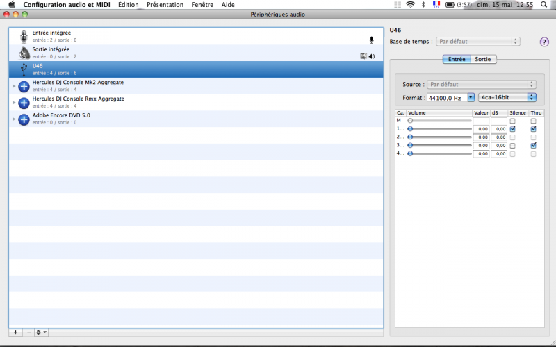

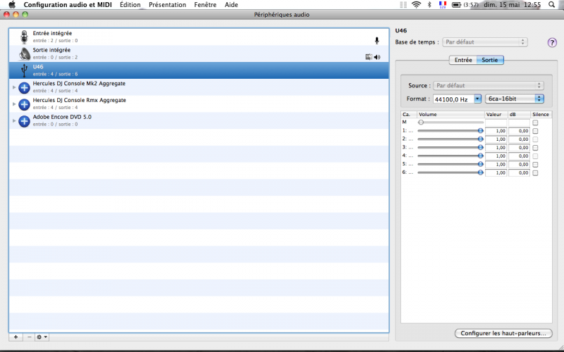

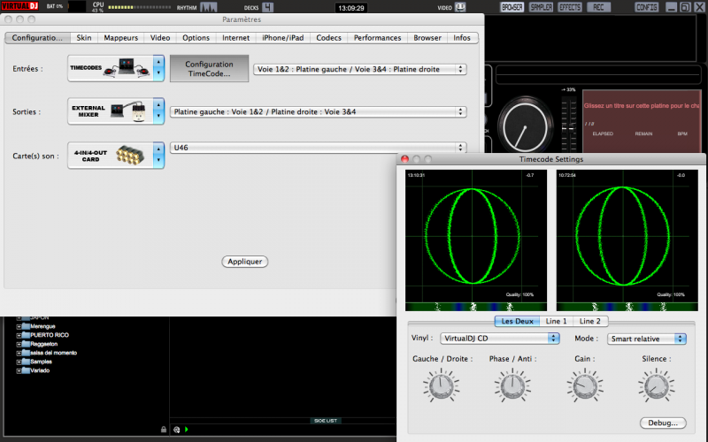

The only thing you have to do on your Mac is that
And that
and on your VDJ that
Don't do anything more mystic...........
Chris
And that
Chris

Thank you for responding,
Got it working thanks to you really appreciate it, Now the only problem is the timecode config how do you get the quality to stay at 100%?
I use the Timecoded CD offered at VDJ, but it is kinda glitchy (pitch suddenly moving, when I press play it takes about 2 counts to get it to start in vdj). Did you do somehting to get it like that?
Kind regards,
