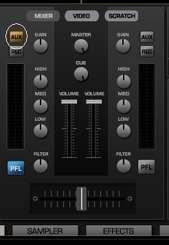

Yep... you would hit the aux button or map a button to "deck 1 linein" to get the line in from the cd player, but you will need the pro version to be able to map the radius if you want to use that as a controller for vdj.

If you wish to use the Radius as a MIDI controller to control VirtualDJ, then you will need to upgrade to the full VirtualDJ Professional at a discount by going to https://virtualdj.com/buy/
DJ Console Edition for Hercules RMX will only work with the RMX console.
If you simply want to play an audio CD in the Radius with the sound going through the RMX like a mixer, then simply plug it into the line inputs on the back of the RMX and then press the SOURCE button of the appropriate deck to enable/disable the input.
Please note that the RMX is not a real analogue DJ mixer so this cannot be used as an emergency backup solution - The RMX and the line input will cease to work if your need to shutdown/restart your computer and/or VirtualDJ.
Assuming that it is not second hand or the discount has not already been used, your RMX DJ Console entitles you to a significant discount (50%) off upgrading to the full VirtualDJ Professional. To receive this, please go to https://virtualdj.com/buy/ and enter your DJ Console software serial number in the box provided.
