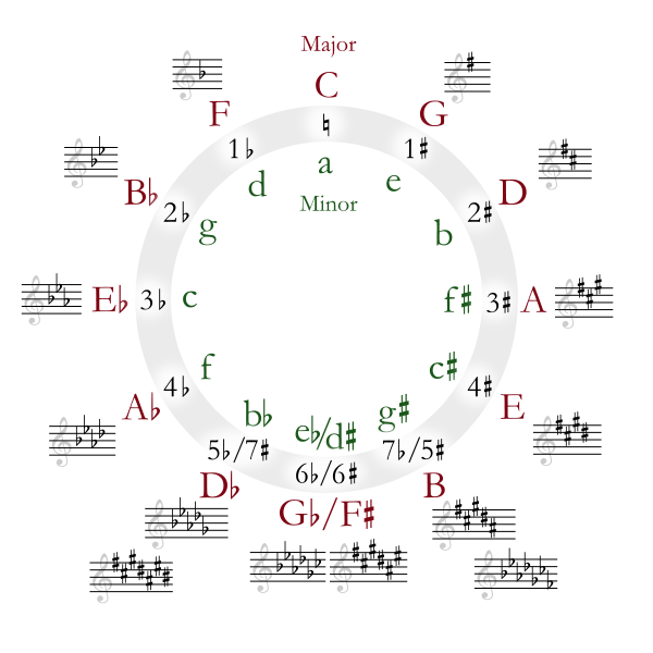

You already have the option, in mixed in key you can choose where to save that info. Then in VDJ just dont have the VDJ\'s key show in the browser....................problem solved ;-)
Huey
And check out the Circle of fifths..................youll see VDJ isnt that bad.............
Huey
