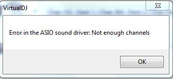

Another little thing I came across is with the PFL on the Twitch
I am assuming that if your using the ASIO driver from novation then you can use the twitch for your PFL etc etc? At the moment if I have the master/cue knob turned to master the volume in headphones is fine. If you move it to cue then it fades away to very little volume and certainly doesn\'t play the song that is selected for PFL in VDJ. I suspect that I have deeper issues with the Noviation ASIO driver anyway as when I select the ASIO in VDJ setup and then select Novation in the drop down I get an error
\"Error in the ASIO sound driver: Not enough channels\"
Wondering if its a limitation of my lappy or the novation usb driver? I did not find any area in novation to download it but i figured that since I had the Twitch version of ITCH installed then the driver would be availalble etc etc but am getting this error.
Anyone else seen this yet?
Or has anyone got some tips on the ASIO setup side of things?
VDJ also seems to crash if you play around in this area too much. Selecting Primary Sound Driver (which I suspect is not the right setting) actually delivers sound to the Twitch unit but only on deck 1 & 2. 3 & 4 dont produce any sound (which I suspect is because I cant get the ASIO driver working correctly)

Audio Setup:
Maks sure you download and install the latest ASIO driver from http://www.novationmusic.com/support/downloads/twitch/, then in Virtual DJ -> Config -> Sound Setup, you want:
Inputs: None
Outputs: Headphones
Soundcard: ASIO / Novation Twitch
That should get all of your PFL and outputs working.
Hope this helps!
