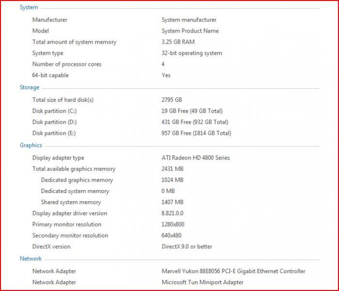

Vista home 32bit...... on the old drive and new..

vista home is not compatible with 4 Gb and as you see in your screenshot it only shows 3.25GB ram so anything more then that is a wast of ram(money) because the os can't see it or use it. the problem seams to be that you system actualy only reads 2 gb of the ram

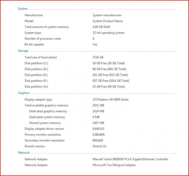

thank you, tere is an issue with this mb seeing all the ram.. the origional drive with the same instal see all 4gigs . why is it seeing all in one and not the other.... but anyways home isnt working on this drive.. what version will???

just for the record,, this is from the origonal drive OP

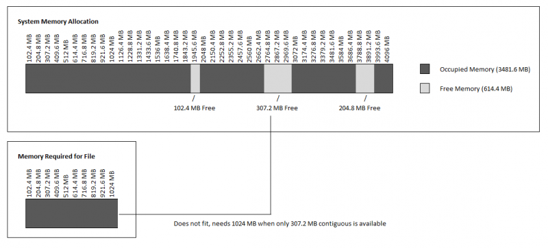

Vista Home does support more than 3.25GB of memory - providing you are running a 64-bit version. This is true for Windows XP and 7 also. Changing your drivers will not help with the problem and is not recommended if your system is performing well already. The issue is as cstoll described. I have made a diagram which I hope helps (the numbers are for demonstration purposes):
Edit: On looking at this problem a second time, perhaps drivers are an issue here. Virtual DJ is only seeing 2 GB of memory. I wonder why that is?
