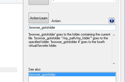

Try browser_sort "stars"
For your folder issue, try playing around with browser_gotofolder

I like the way you think, I would have never thought of stars... Cheers, for the folder I have so far tried every combination I can think of, but because its not actually a folder or even a virtual folder it doesn't seem to work.
I have tried:
gotofolder compatible anthems
gotofolder compatible_anthems
gotofolder filter "compatible anthems"
gotofilter_folder compatible anthems
I even tried to input the filter script into vdj script:
search " bpmdiff<=5 & keydiff=0 & rating>=5"
I think I might have to put the word anthem in feild 2 then just use:
search "anthems"
I have tried:
search "anthems"
Posted Sun 13 Mar 11 @ 6:04 pm
I think you must read again the description above.
You can specify the path only for the REAL folders.
Virtual Folders are not REAL, they dont have a path. So the only way to access them with the above script is to specify the order number.
In case you need a specific Virtual Folder to get accessed by a shortcut, place it in the first place (higher as you can) and simply assign
browser_gotofolder 1
browser_gotofolder 2, 3, etc will give you the second, third, etc Virtual folder in order.
The above code is not working for Filter Folders i'm afraid. Although the description says Virtual/Favorite it would be nice to work and with the Filter Folders. I'm going to report it as a bug.
Posted Sun 13 Mar 11 @ 7:25 pm
