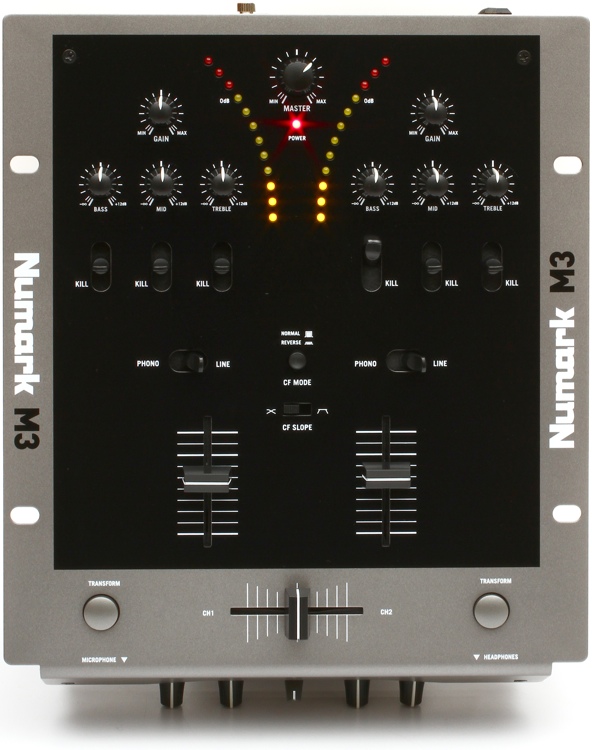

Wow! djnutz, you are awesome!
Your posts are so detailed which is what I like, I can't stand when someone gives me a generic answer. You have been a HUGE help.
Good news, I think, my mixer does have a PHONO/LINE switch. Well at least I think it does... I put some URL's to photos and case you wanted to see, one is a top view and one is the back of the mixer.
TOP:
http://www.sweetwater.com/images/items/750/M3mixer-large.jpg
BACK:
http://www.sweetwater.com/images/closeup/xl/1600-M3mixer_back.jpg

HAHA! I have the same mixer. Switch that switch from Phono to Aux Line on the back. The switch above the channel fader is the one that will switch your signal from direct from CDJ to PC.

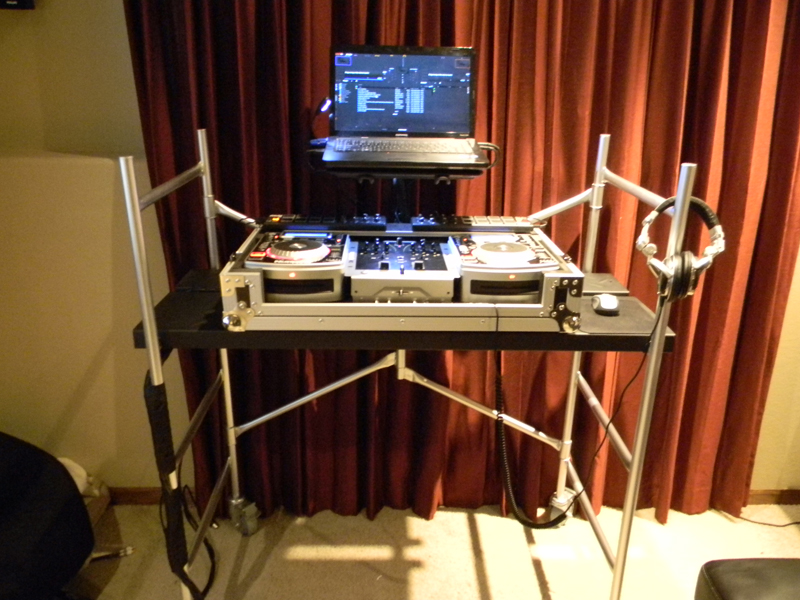

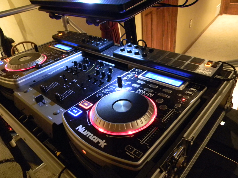

Wow, that looks awesome!
Are those yours?
Cause if they are, we have the same setup, basically!

That is my setup.
