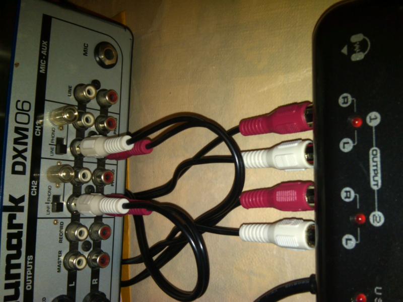

This is how you connect your versaport to your mixer.
Turn on the radius and set them on MIDI mode, make sure that VDJ is set up to read the versaport audio card, and you are ready to start playing your music.
