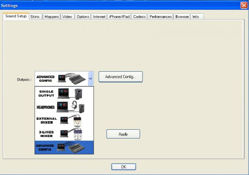

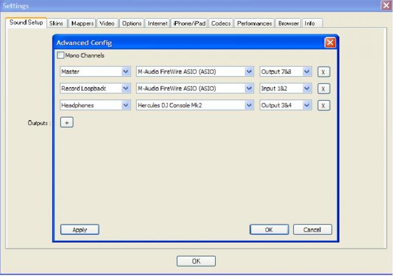

There is something very wrong here,
When I try to setup my inputs and click on the "Inputs" option box in "Sound Setup" tab and clicked advance to set up my inputs, it automatically defaults to output, when I set all the in's and out's in this dialog and apply I get a message that the "inputs have not been assigned and will not record audio" as per massage when I reopen advance config.
And it's correct because it doesn't work at all....
Shouldn't there be a dialog in advance for inputs and one for outputs like in must all recording software, it would make it a little more less confusing...
Joey...
Joey...

I would say this is an error message of your Soundcards ASIO driver. You should open the manufacturers ASIO panel to see if you have to configure some things first before using them in VDJ.
Greets, Heiko

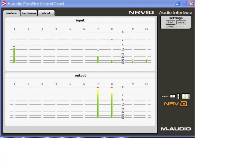

All M-Audio Audio Interface are working properly and are registering all signals from VDJ and mic channel as per image..
Joey...
Joey...

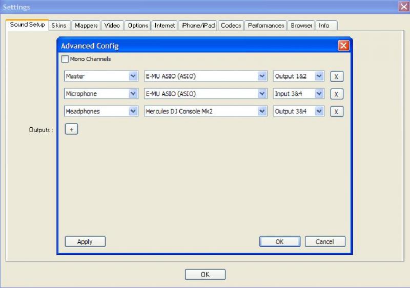

I did the same test using my E-Mu 1616m sound card and still the same results, can't get it to record and still the same message after a successful setup with no error messages..
Only after I go back into advance setup do I get a message that no audio could be recorded...
I use this equipment all the time to record through my Ableton Live 8 software with abosolutely no problems at all, so this is strange what is happening..
Could the advance dialog defaulting to output even though you've chosen it from the "Input" option in the sound card menu have something to do with this problem..???
Joey....

Edit-@Joey, where's your record loopback in the picture above?? You need that so VDJ knows where to record from. Atleast in my mind I think that's how it works, lol!!
Edit- Yeah your missing the record loopback in both your pictures of the advanced config screen.
Its that easy bro I swear. Im gonna try and get this dam video up even if I have to record it again with my phone.
Huey

@Joey, basically the way you have it setup VDJ thinks that\'s an actual mic. What your telling VDJ is that that\'s where your microphone is coming in from. So in that same tab choose \"Record Loopback\" in that tab. Now in the drop down next to that choose the soundcard that your INPUTTING your sound or mixing board into. In the drop down next to that choose the input number (1/2, 3/4 5/6 etc.....). Now click apply and started recording!! You can even BROADCAST with it setup like that! Meaning you could have a live band or rappers on air live!!

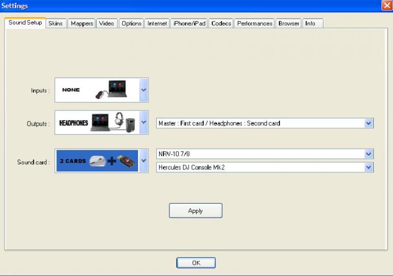

Well after alot of switching things around, I removed the E-Mu sound card and only used the mixer, I got the Mic to record, but now the music doesn't record and the mic track plays back on the left channel only..
The Music and Mic play good while recording through the speakers L/R
I set up as a two card config and the music was recording good, but no mic recorded...
Any Ideas.??
Joey...

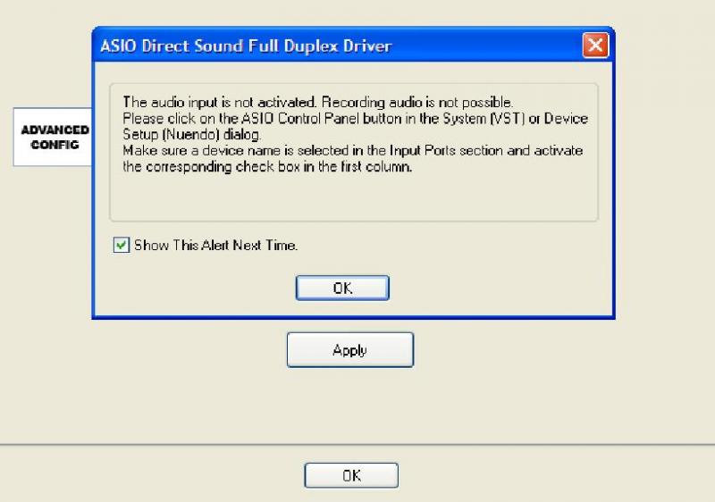

I still get this message when I go into advance settings.
Anybody know why I'm getting this message, how can I fix it...????
Thanks,
Joey....
