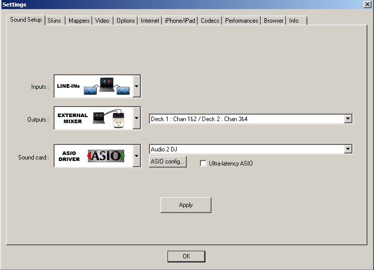

Simple is the word, so easy to install, and yes it does fit in your pocket. My only concern, is that, even though it works, every time I load up VDj it tells me that there is an error in the ASIO card because there not enough channels.

this is how I have it set up.
I'm noticing a few more glitches, when I move the pitch on my radius 3000, I hear a crackling sound, channel A sounds lower than channel b.

I think I have solved my problem. As you can see by the picture, I had my set up to inputs - line-ins which was, to what I think, giving me the problems.
I just did a quick test run on inputs - none, and the crackling sound went away, sound was balanced, and the error went away.
Posted Thu 24 Feb 11 @ 12:43 am
Inputs: Line-INs might give you problems because the Audio 2 DJ does not actually have any inputs.
You need it set to Inputs: None
If you still get any crackling or stuttering in the sound output, then this may be due to performance issues with your computer - Please see http://www.virtualdj.com/homepage/jpboggis/blogs/4094/Common_performance_issues_and_solutions.html for a list of common causes and their solutions.
Posted Thu 24 Feb 11 @ 10:33 am
Thank you VDJ for your support. Yes, I switched it from line-ins to none, and all the problems are now gone. Thank you once more, and now I'm off to enjoy my new sound card.
