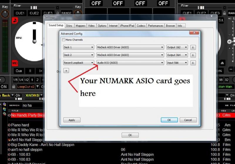

It is a Hardware Design -- period.
This is nothing new - it has been posted several times that the mixer area of the MixDeck is a standard mixer.
If your laptop has a 'true' line in then use that.
Advance Config -
Deck 1 - MixDeck - Output 1&2
Deck 2 - MixDeck - Output 3&4
RecordLoopback - Laptop sound card - Input 1&2 <-- if that is the correct option for your line in port, it might be 3&4 if you have an onboard mic as well.

Ok, ok, dang Chris gimmie a break...........After a couple of hours messing with my onboard soundcard I got it to work!! Yeah I'm not a total dummy!! Yes with the decks in MIDI mode aswell but because the on board soundcard (Realtek) is not made for this type of stuff there was heavy distortion........ So it is possible to record the Mixdeck like you said a few post ago. Well I found a way around the distortion. I had an old Behringer UCA200 (came with a podcast kit) that I just routed the booth out into and it works perfect!! I can record not only whats playing in VDJ but also cd's or if I plug in a flash drive or even my mic.
So with that all out of the way I have 1 last question, if youd be so kind to answer, with the way I have the record loopback set up to record will those settings also work if I were to broadcast??

Hey Beat breaker can you give me a visual of the recording solution. I am a vision type person. Thanks. By the way I have a Numark ASIO soundcard.

Try it like this and let me know if it works for you,
Run a line from your BOOTH OUT into your NUMARK ASIO card. You might have to record for a min or 2 to check your levels if your card doesnt have a VU Meter on it.

hey beatbreaker i am having the same problem with my numark mixdeck! i read the previous posts and it looks like you got it to work but i dont understand how you did. i am very unexperienced could you please help me in a more understandable way :)
I would appreciate it greatly!!! thanks so much
