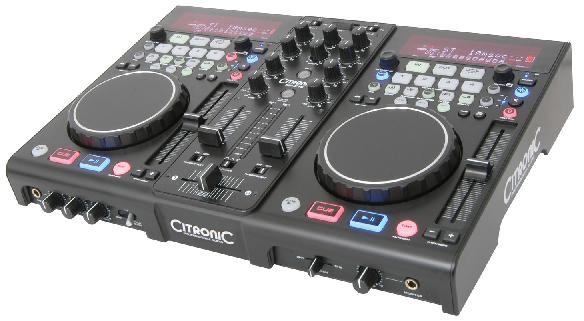

The Brand "VOXOA" doesn't sell in Europe. I know the same model but not the same brand sold in Europe. You can check it out the "Citronic MP-X10"
