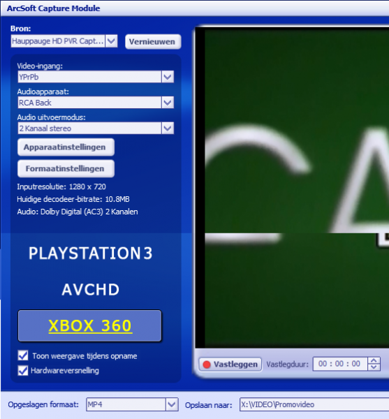

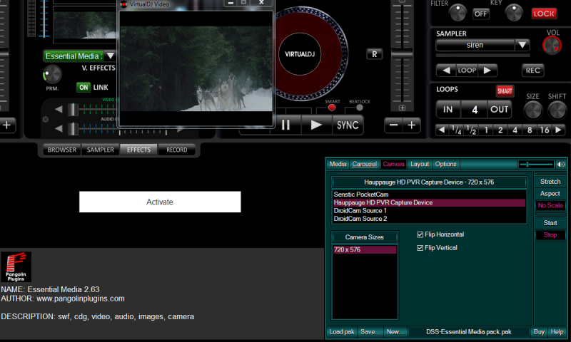

Hi Don,
I’ve been testing this great Essential Media plug-in. This issue is about the camera function.
I have no USB webcam, but instead of that I hooked up my Cannon HD camera via the Hauppage HD PVR box.
Displaying and recording the video via the Hauppauge capture program or via Total Media Extreme program, works great.
So I’ll thought to use my Cannon HD cam for live video within VDJ via the HD PVR capture card.
When I enable the camera plug-in from Essential media, I can select the HD PVR, but no video output.
I’m using the RGB input on the HDPVR (1280x720) while the essential media plugin shows only input from 720x576 – and no other selection seems to be possible.
With TME (Total Media Extreme) Capture program, this is what I have to set. (XBOX is to record MP4)
When I select Composite as input: TME & HD PVR in essential media has now same resolution. – still no video. (when I click the Start button, it jumps immediate to the Stop button again.)
Perhaps you have an idea to solve this, but I understand that if you don’t have the specific hardware it’s difficult to investigate.
Anyhow it would be a great add-on if the HD-PVR input should work.
Johan
Note: I’ve also tested with the camera of my Ipad via Pocketcam & DroidCam . That works fine but picture quality isn’t so good.
